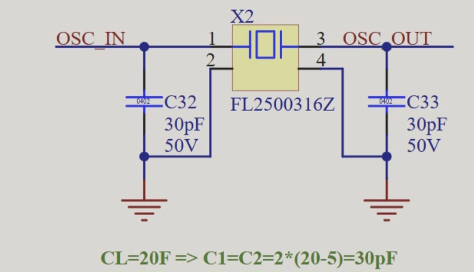

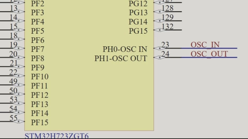

After that, I designed my own board with the same microcontroller and added an external 25 MHz crystal.
I couldn’t get the 25 MHz clock to work.
This is the cofiguration:

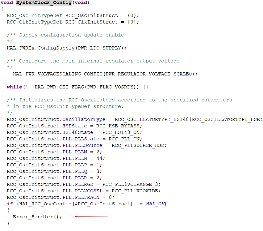

I try to debug my code and I saw that I get error at
SystemClock_Config:
Error_Handler();
here:

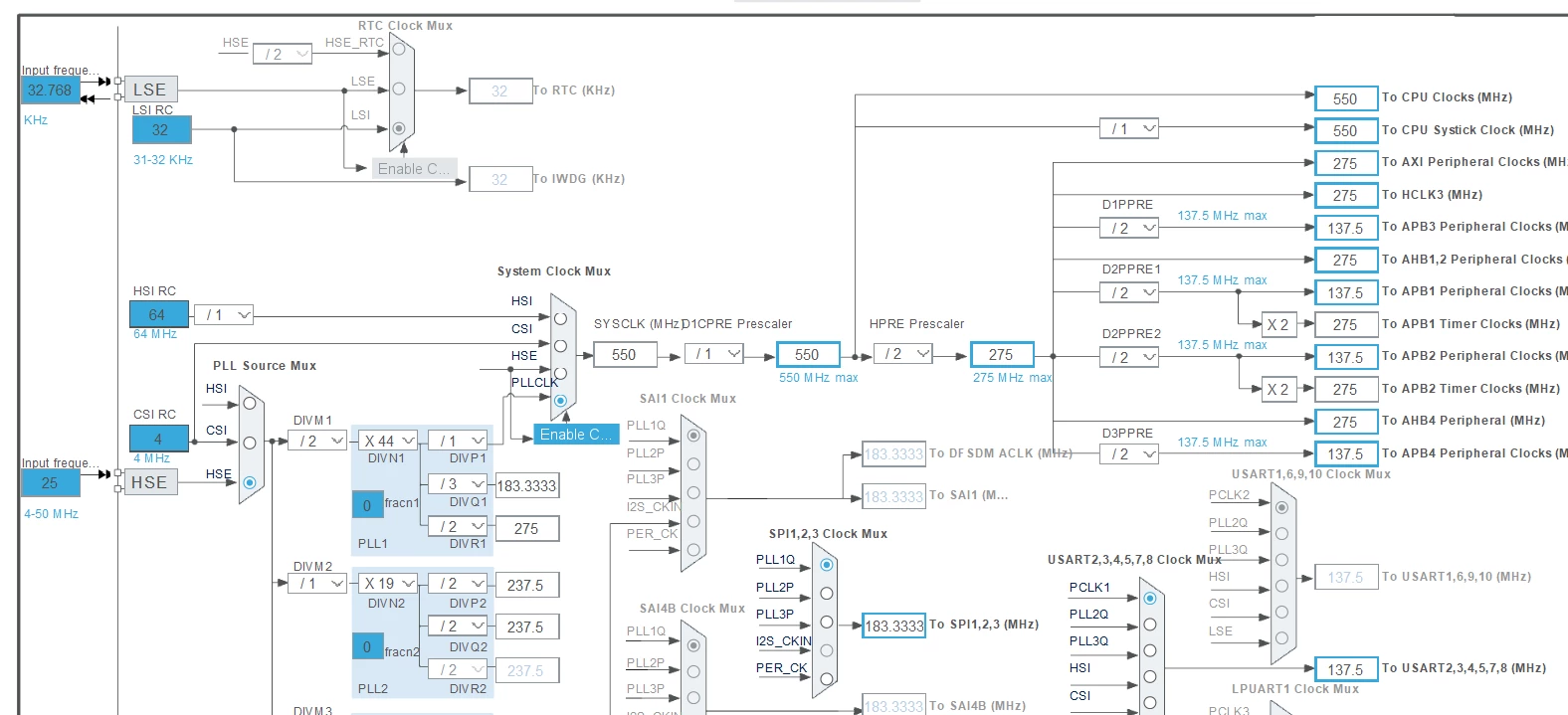

I switched to using the internal clock of the MCU to work with HSI.
The code runs normally, but I don’t see any signal at the DAC output.
This is the configuration:
Thank you very much

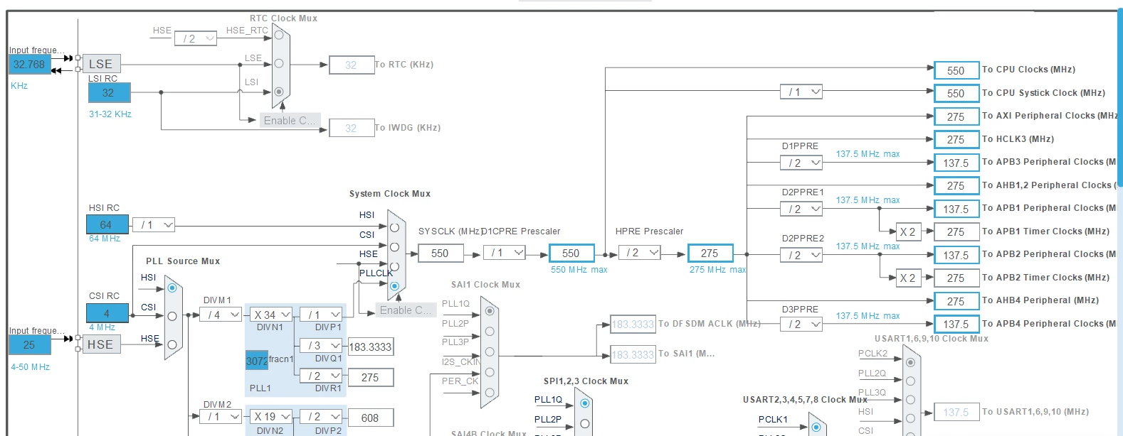

You set the crystal input to "bypass" - you use really a crystal or an oscillator? (this works not for plain crystal.)
For crystal set it to ...crystal ..resonator.
Maybe - show your circuit, to see more.
Cube not complains about this 608 M setting ?
Try lowering all speeds first, just to be sure, its not something with too high clks.

The cube not complains about the 608.
I attach what I work with.
and what about work with the internal clock? HSI? why is not work also

so you have a plain crystal -> set in Cube :
your cer.caps at the crystal are way to big , for 25M : try 6pF or ... 10pF .
for 25M crystal typ. : 2x 5.6 pF (on nucleo board MB1363 , dnf)
