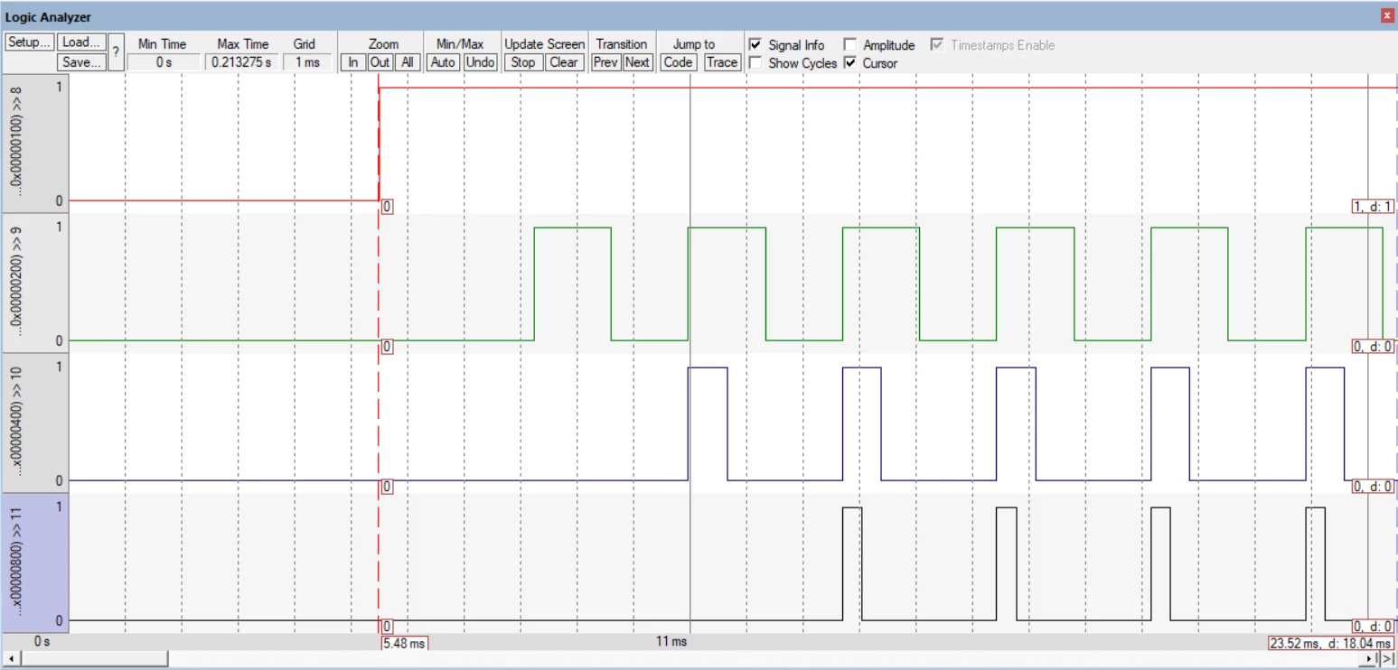

Problem with a Timer DMA Burst mode
NUCLEO-F103RB with STM32F103RB
I want to use the DMA in a burst mode to write data from buffer in RAM to the TIM1_CCR1,2,3,4? that are in PWM mode. DMA burst transaction is requested on the TIM1 Update (UEV). Number of transactions in Burst mode is set to 4 transactions. According to the Reference Manual on each DMA Burst request 4 values from the buffer in RAM have to be transfered simultaneously to the CCR1,2,3,4. What I actually see is that on each TIM1 Update Event ONLY ONE TIM1_CCRx register is getting updated with a new value from the buffer.
Is that how it sappose to work, and if not where can be a problem?

Here is the picture I get in Keil's Logic Analyser
I'm using simulator now and in a long time will not be able to test program on a real MCU.

Thank you all for your help. I finally got access to my board and to a real logic analyzer (thanks quarantine for all that wasted time hehe), The Tim DMA-burst feature works fine irl, problem was in the Keil's simulator.

waclawek.jan
Apr 27, 2020 6:59 PM UTC
OK, but this can be also consequence of the simulator not being perfect.

That paragraph is about the DMA burst feature of the DMA peripheral.
Your program attempts to use the DMA burst feature of the timer peripheral, which is supported across all general and advanced timers on all STM32 products including the STM32F1 series.
As the very next paragraph makes it clear, there is no contradiction at all.
The information stated above aims to mitigate any misunderstanding of this feature and any possible confusion with the STM32 timer burst feature which makes the focus of this chapter.
There is even an example project showing the timer DMA burst feature of the STM32F103 among the example projects in the STM32F10x standard peripheral library distribution, see Project/STM32F10x_StdPeriph_Examples/TIM/DMABurst
waclawek.jan
May 2, 2020 8:53 AM UTC
No.
While there are two different DMA IPs in various STM32 families, and the single-port DMA used in 'F1 is indeed not capable of AHB bursts, it's not the cause of your problem, as it's not related to AHB bursts.
There's another feature ST calls - in an unfortunate way, causing this kind of confusion - burst. Namely it's the mechanism where in timers, a single initial trigger source results in a series of triggers for DMA. This mechanism involves the TIMx_DCR/TIMx_DMRA registers, and this mechanism is present in the 'F1 - see what your line
TIM_DMAConfig(TIM1, TIM_DMABase_CCR1, TIM_DMABurstLength_4Transfers);
does, and also see whether your 'F2 code sets any of the burst fields in the DMA control registers (it does not).
The 32-bitters are extraordinarily complex breasts, even the simplest of them is. It's next to impossible to build a faithful simulator.
