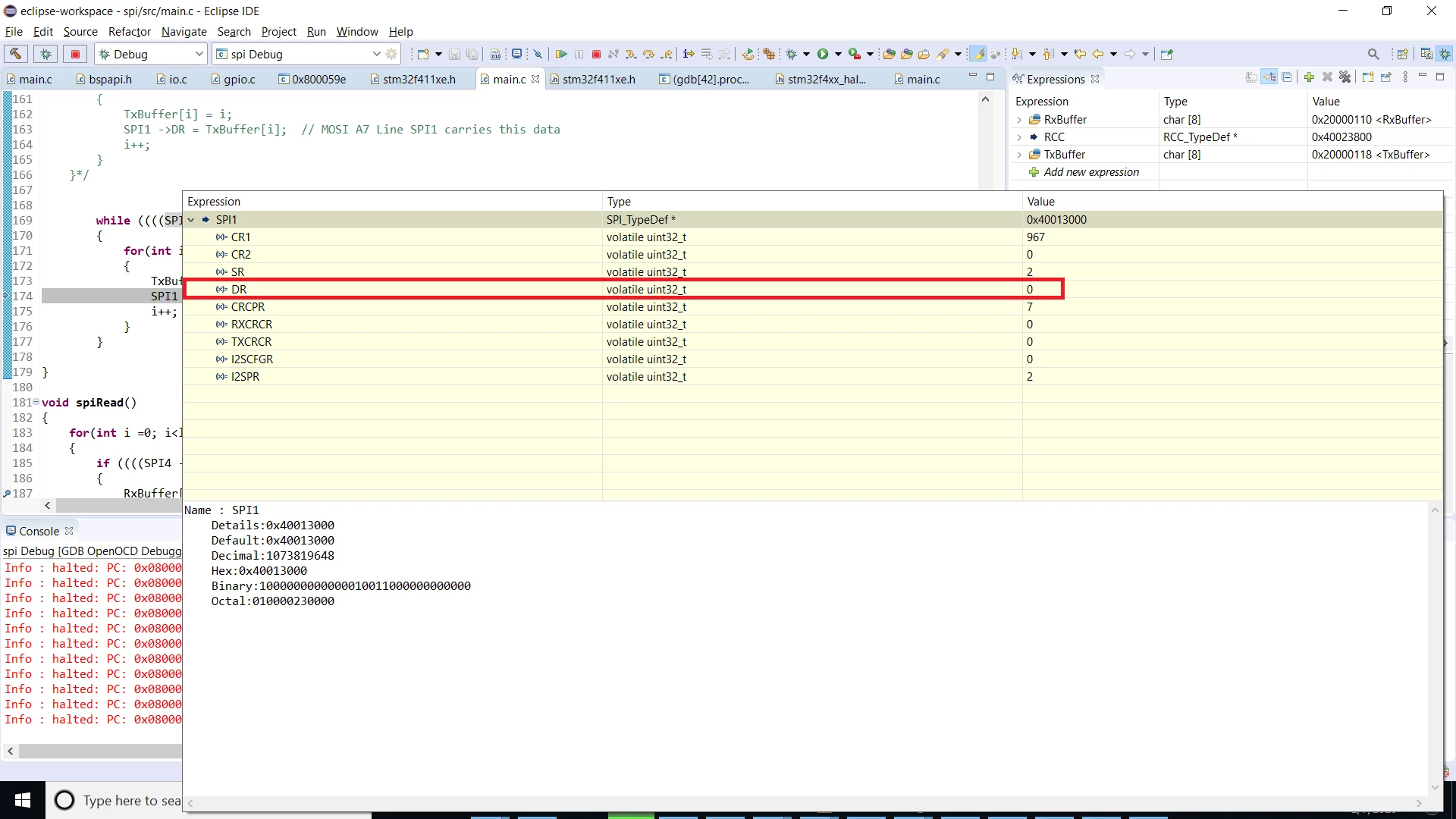

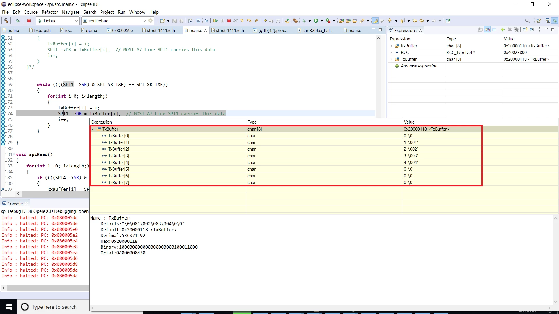

0690X00000D8Pv5QAF.png0690X00000D8PoiQAF.pngHi KnarfB,
I've edited code as you've mentioned above, Still I couldn't find an changes also the data isn't reflected/ written to SPI Data register. I have attached screenshots for your reference. If subsequent read and write is a problem, I had change the code such that It performs only spiWrite(), still the data is not written into the register.
while ((((SPI1 ->SR) & SPI_SR_TXE) == SPI_SR_TXE))
			for(int i=0; i<length;)
				TxBuffer[i] = i;
				SPI1 ->DR = TxBuffer[i]; // MOSI A7 Line SPI1 carries this data
				i++;
KnarfB
February 7, 2020
> Therefore, you need another while loop within the for.
You have to wait (poll) for each and every individual byte/char.
Here is a small example using SPI2 and SPI3 on a Nucleo-F446RE. It assumes that the GPIOs are already configured and copies the string from tx to rx buffer via SPI:
static char tx[16] = "Hello\r\n";
 static char rx[16];
 SPI2->CR1 = 0;
 SPI2->CR1 |= SPI_CR1_SSM;			// NSS in software
 SPI2->CR1 |= SPI_CR1_SSI;			// Internal slave select
 SPI2->CR1 |= SPI_CR1_MSTR;			// master mode
 SPI2->CR1 |= 5 << SPI_CR1_BR_Pos;		// 64:1 bitrate
 SPI2->CR1 |= SPI_CR1_SPE;			// SPI enable
 SPI3->CR1 = 0;
 SPI3->CR1 |= SPI_CR1_SSM;			// NSS in software
 SPI3->CR1 |= SPI_CR1_SPE;			// SPI enable
 for( int i=0; i<strlen(tx); ++i )
	 while( !(SPI2->SR & SPI_SR_TXE) ); // poll for TX empty
	 SPI2->DR = tx[i];
	 while( !(SPI3->SR & SPI_SR_RXNE) ); // poll for RX non-empty
	 rx[i] = SPI3->DR;
HAL_UART_Transmit( &huart2, rx, strlen(rx), HAL_MAX_DELAY );
Note that this is a toy example because the slave SPI needs to poll all the time to listen for (and not to miss) incoming chars. So, finally you might want to add interrupt handling or DMA. Note also that slave select is not handled here.
