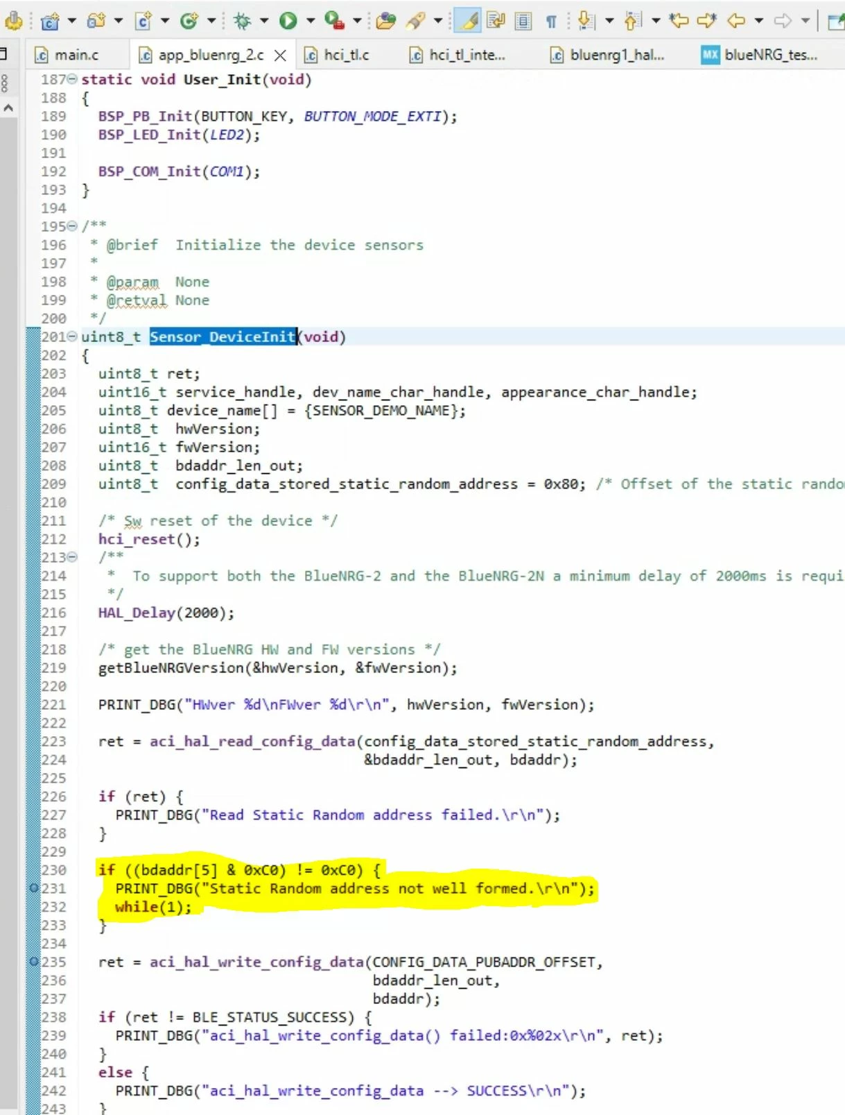

Problem when starting a project stm32f407zgt6 mcu using X-CUBE-BLE2 + BLUENRG-M2SP
  • June 23, 2022
  • 1 reply
  • 1073 views
After initializing the project, I freeze waiting for the presence of data of type 0x04 in the list in function Sensor_DeviceInit() - app_bluenrg_2.c. Please tell me what could be wrong?
Best answer by MarkAvreliy
Good day! Everything is fine, the problem is solved. It consisted in the fact that several subscribers hung on the SPI bus. Disconnecting all the others, the module worked, examples from the X-CUBE BLE-2 package work perfectly. Thank you!
