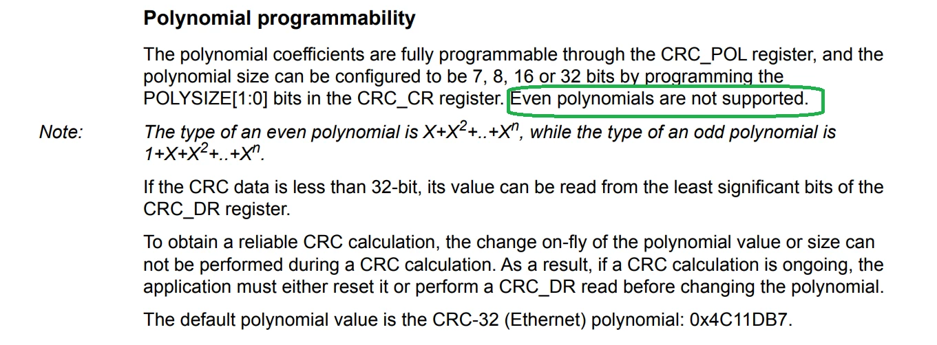

@STOne-32 @STTwo-32 "Why does HAL layer only allow ODD parity polynomials?"
https://community.st.com/t5/stm32-mcus-security/can-the-stm32-crc-peripheral-be-abused-into-doing-crc-24q-or/m-p/65228
Case in point I can also do 24-bit and 15-bit CRC's where I do ALL the work in the high-order bits
STOne-32
Oct 12, 2024 1:57 PM UTC
Dear @Tesla DeLorean  @BradWalker ,
Thank you for the interesting exchanges, the main is reason is simply because our specification / manual say it.
here an example of our reference manual for STM32G4 series : STM32G4 series advanced Arm<Sup>®</Sup>-based 32-bit MCUs - Reference manual  ,
Go to Page 456/2138 from Manual revision 8.
I fully understand it might work perfectly at your end , but from our side, we do not support the behavior or results as it could be never tested/verified as at industry level  Odd Polynomials are the mostly used.
Hope it helps to clarify the topic.
STOne-32.
