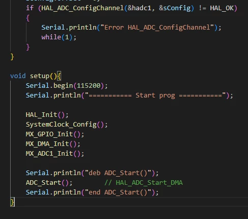

I am trying to use DMA for the first time with an ADC.

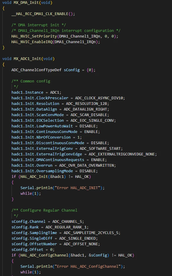

I think I have configured my ADC and DMA correctly to work together (see configuration below).
Using the debug I notice that in the HAL_ADC_Start_DMA function, the LL_ADC_REG_StartConversion function blocks the program and I never exit it. If I read the comment of this function, it says "If software start has been selected, conversion starts immediately."
I think that in my ADC configuration I have configured "software start".
Does anyone have any idea what the problem could be?
Thanks.
