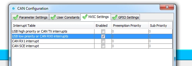

Hi all!
I am new in CAN bus with STM32. I have a project using multi stm32f103 in a CAN network. I want to set up a STM32f103 as a Master CAN device, and others stm32f103 are as a slaver in CAN bus.
I set up a stm32f103 as master, it worked well. because i received successfully my data with a stm32f407 discovery. But when I set up a stm32f103rct6 as a Slaver Can device, it CAN NOT get data, i using interrupt to get data, all parameters is the same with STM32F407. I dont know why????
In CUBE MX set up for CAN. Stm32f103 have only one CAN, and may be only for Master Device, not for set up as a Slaver. Is it right???
anyone can help me?
thanks all!

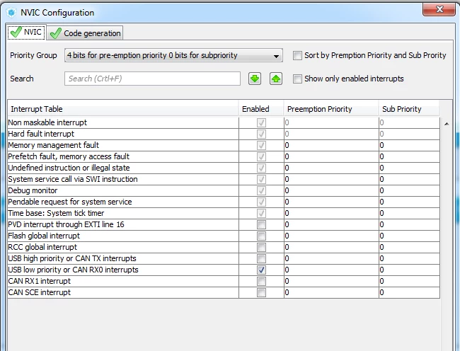

    @TJ Did you used Stm32f103 for your Project?
    Can you tell me how to set up for receive data using interrupt.
    I debug buy ST-Link and see that: My stm32f103 received correctly data in RXFiFo, Over and full Flag are set. But Interrupt did not happen,
    I set options for CAN_RX in CubeMX like that: (see figures)
    • In CAN set up, choose: USB low priority or CAN RX0 interrupts (in my code i using FIFO 0 to receive data)
    • in NVIC set up, is the same (auto)
    and in my code, i set up as my attach files above
    I think i have something wrong.
    Can you check for me ?
    thanks!
