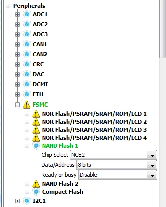

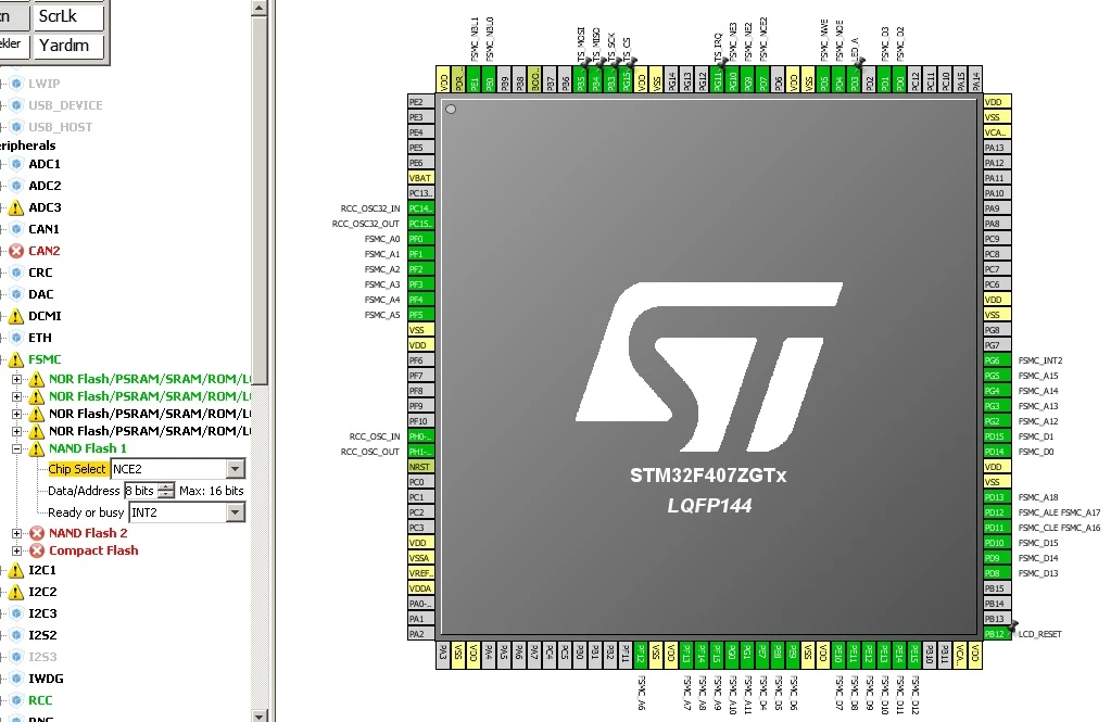

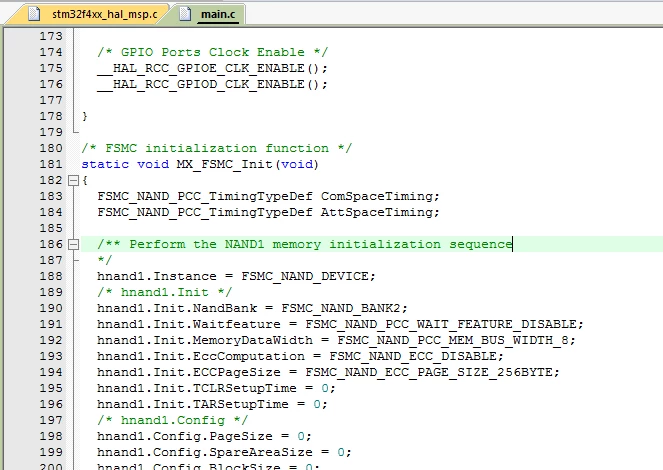

    Jeanne Joly
    January 30, 2018
    Posted on January 30, 2018 at 09:13
    Hi
    Matras.Tugrul
    Granados.Elkin
    and
    Tekampe.Jens
    Regarding
    Matras.Tugrul
    'spost, you can change the value of
    hnand1.Init.Waitfeature in the pinout view/FSMC/Nand Flash1/ Ready or busy (I am working on the lastest CubeMX release 4.24) :
    it will automatically generate the following code :
    BR. Jeanne
