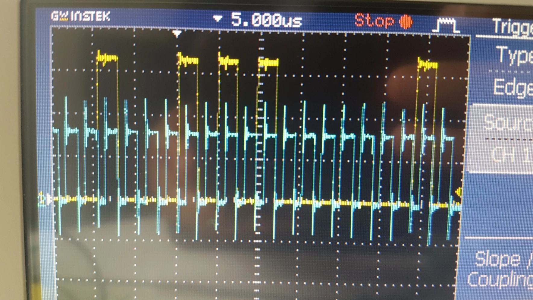

0693W000001qVfmQAE.jpgIm trying to write to and read data from 10 eeproms in parallel. I first transmit the data in parallel to all the eeproms via spi, I then read data in parallel by first transmitting the address of data stored in the eeprom and then transmitting dummy data in non blocking mode in order to pass a clock signal to eeprom and allow it to output data stored.

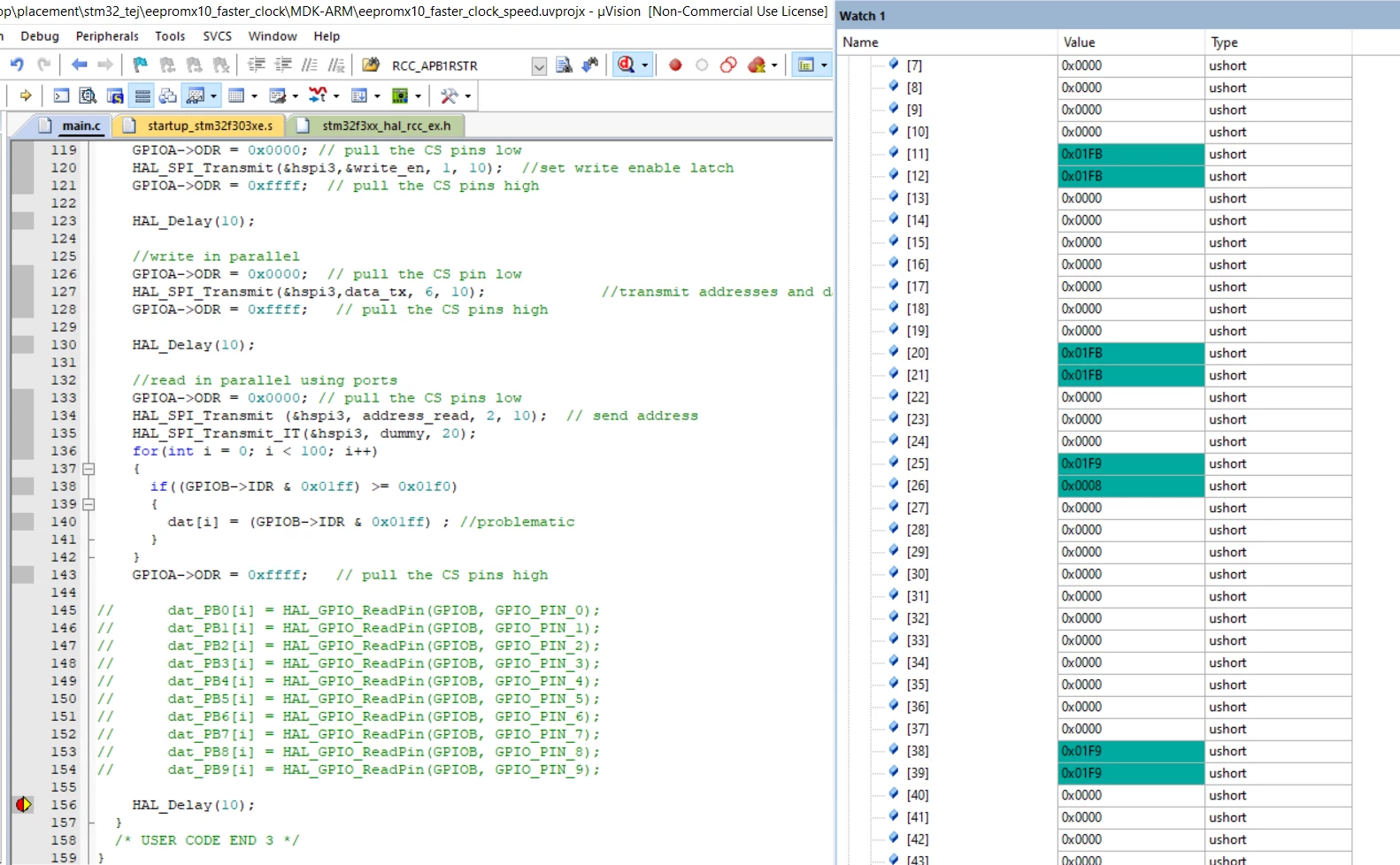

From the signals on my oscilloscope everything works perfectly, the eeprom outputs data I send it. However when trying to read the gpio pins in order to record data only the first 4 bits in every byte gets read as observed from debug mode.
Attached is my code and relevant pics.

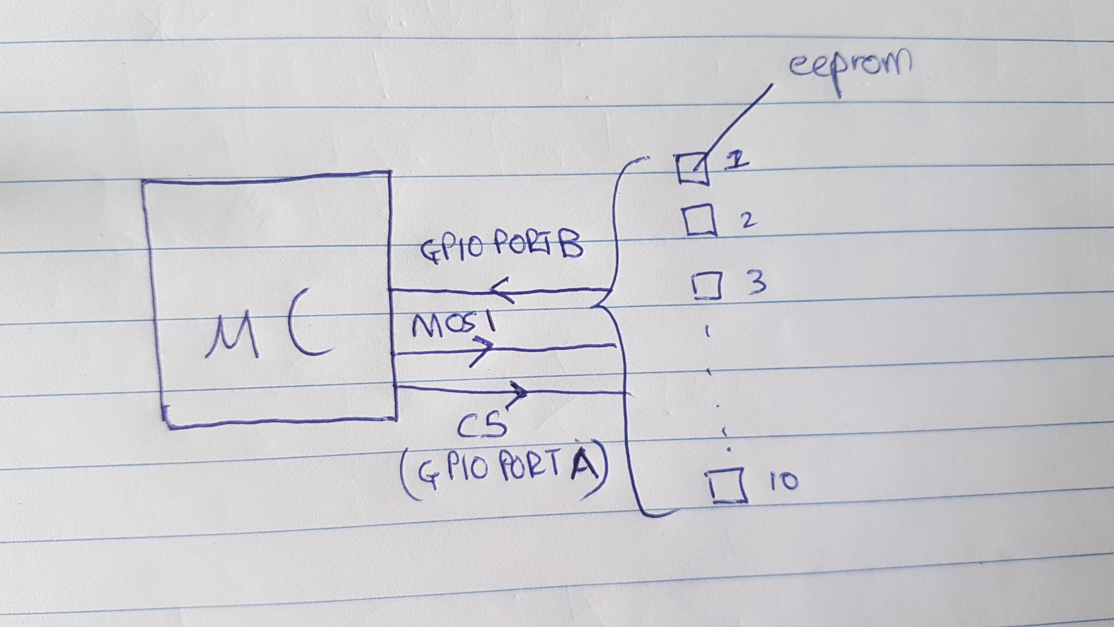

waclawek.jan
Jun 11, 2020 12:14 PM UTC
Maybe a diagram or sketch of the hardware connection would help us understand, what are you trying to accomplish.
Jun 11, 2020 12:15 PM UTC
Not sure I follow what your code is trying to do.
This loop doesn't send any clock output. Why would the IDR value change from loop to loop?
		for(int i = 0; i < 100; i++)
			if((GPIOB->IDR & 0x01ff) >= 0x01f0)
				dat[i] = (GPIOB->IDR & 0x01ff) ; //problematic
TSa.1
TSa.1Author
Jun 11, 2020 12:23 PM UTC
Tnx for answering TDK
Well HAL_SPI_Transmit_IT(&hspi3, dummy, 20); transmits dummy data (just 0), so essentially it only passes a clock to the eeproms. Since the previous line of code HAL_SPI_Transmit (&hspi3, address_read, 2, 10); requests eeprom to send data from the particular access as soon as it receives the clock it begins outputting data. Each eeprom outputs darta to its respective gpio pin

TSa.1Author
Jun 11, 2020 12:21 PM UTC
Tnx for answering,I hope this block dig helps waclawek.jan0693W000001qVfmQAE.jpg

Instead of calling HAL_SPI_Transmit_IT, you should be toggling SCK manually and then reading GPIOB on each cycle. You have no delays in your loop and no method to ensure each call is at the right time with respect to the SCK line state.
TSa.1
TSa.1Author
Jun 11, 2020 12:29 PM UTC
Thats a good suggestion, I wasnt able to find out how to toggle sck manually. How do you go about this?
Jun 11, 2020 12:37 PM UTC
Reconfigure it as gpio and toggle as needed.

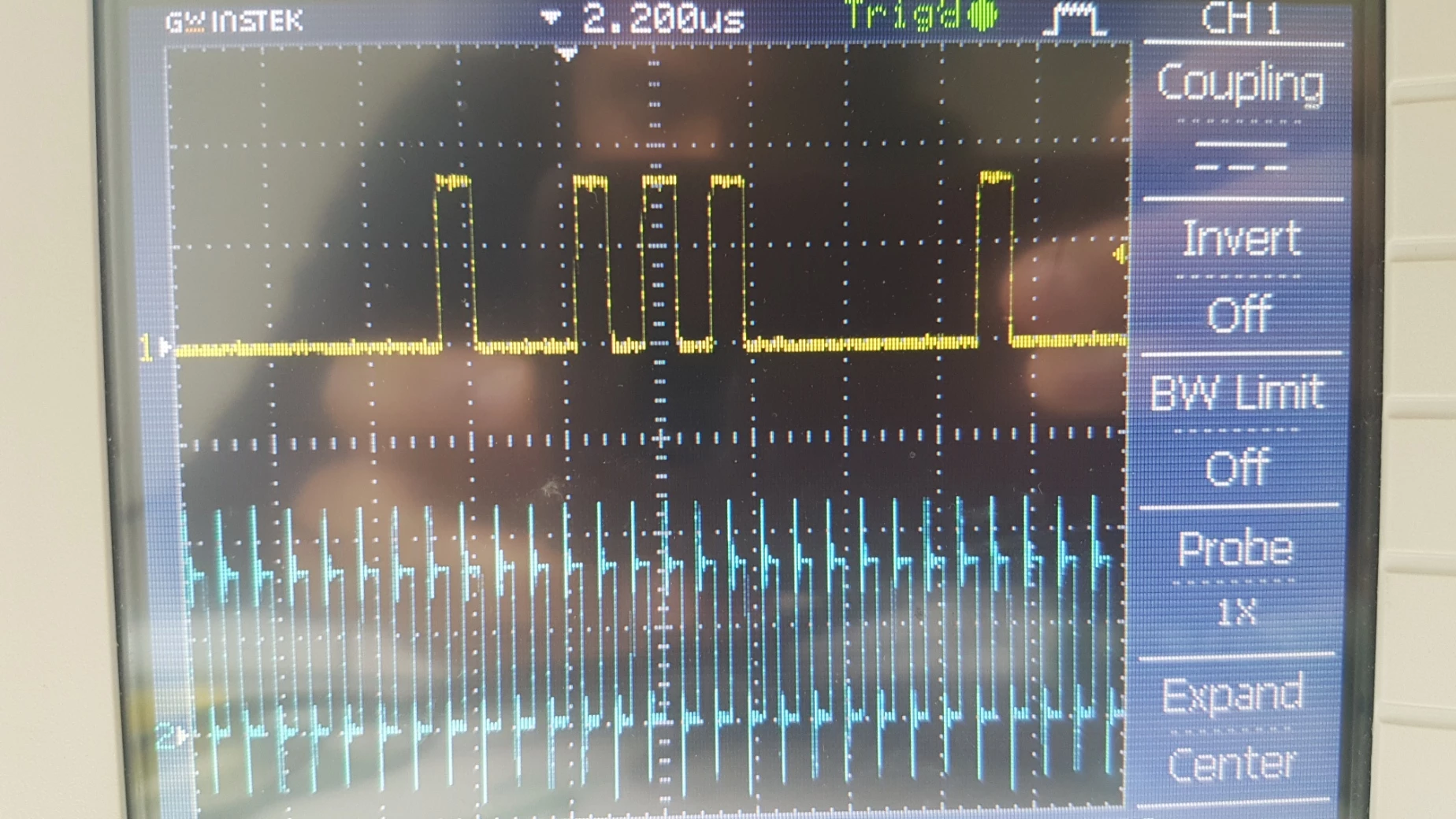

waclawek.jan
Jun 11, 2020 2:24 PM UTC
> it doesn't seem to work
What are the symptoms?
Did you observe the pins (SCK and some of the MISO/PBx)?

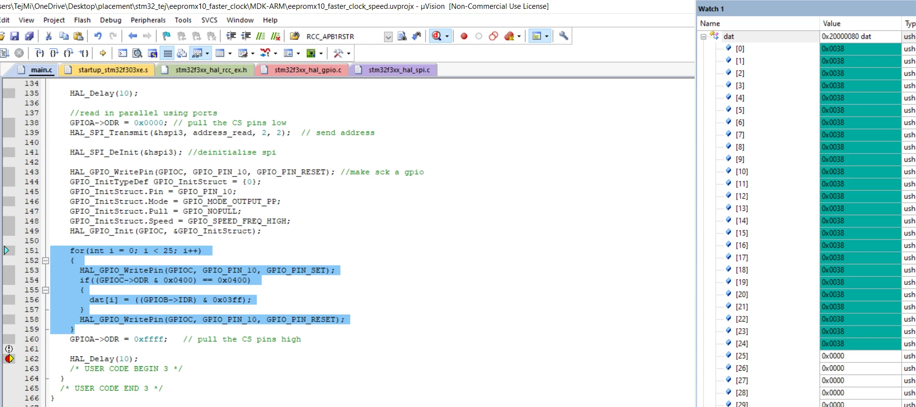

TSa.1AuthorBest answer
Jun 11, 2020 5:14 PM UTC
while (1)
 /* USER CODE END WHILE */
		HAL_GPIO_DeInit(GPIOC, GPIO_PIN_10);
		MX_SPI3_Init();
		//set write enable latch in parallel
		GPIOA->ODR = 0x0000; // pull the CS pins low
		HAL_SPI_Transmit(&hspi3,&write_en, 1, 1);	//set write enable latch
		GPIOA->ODR = 0xffff; // pull the CS pins high
		HAL_Delay(10);
		//write in parallel
		GPIOA->ODR = 0x0000; // pull the CS pin low
		HAL_SPI_Transmit(&hspi3,data_tx, 6, 6);						 //transmit addresses and data
		HAL_Delay(10);
		//read in parallel using ports
		HAL_SPI_Transmit(&hspi3, address_read, 2, 2); // send address
		HAL_SPI_DeInit(&hspi3); //deinitialise spi
		HAL_GPIO_WritePin(GPIOC, GPIO_PIN_10, GPIO_PIN_RESET); //make sck a gpio
		GPIO_InitStruct.Pin = GPIO_PIN_10;
		GPIO_InitStruct.Speed = GPIO_SPEED_FREQ_HIGH;
		HAL_GPIO_Init(GPIOC, &GPIO_InitStruct);
		for(int i = 0; i < 25; i++)
			HAL_GPIO_WritePin(GPIOC, GPIO_PIN_10, GPIO_PIN_SET);
			if((GPIOC->ODR & 0x0400) == 0x0400)
				dat[i] = ((GPIOB->IDR) & 0x03ff);
		HAL_Delay(10);
 /* USER CODE BEGIN 3 */
So it works now, I get a correct output on the oscilloscope. However, I dont think im sampling data GPIO correctly:
I transmit 3 bytes: 1,21,1 but this is what I see in debug mode:
What do u think is the issue?
TSa.1
TSa.1Author
Jun 11, 2020 6:10 PM UTC
Nevermind, this works now! I dont know why it started working all of a sudden
