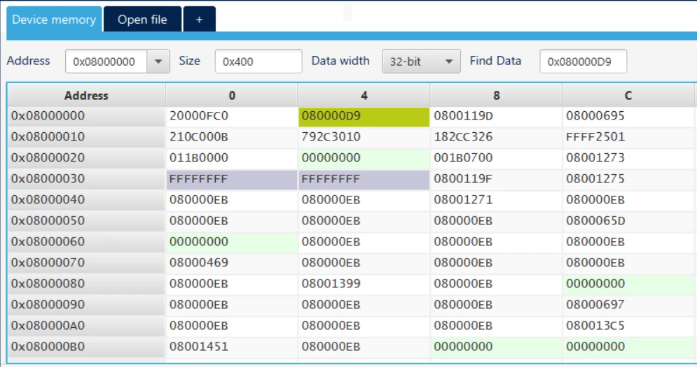

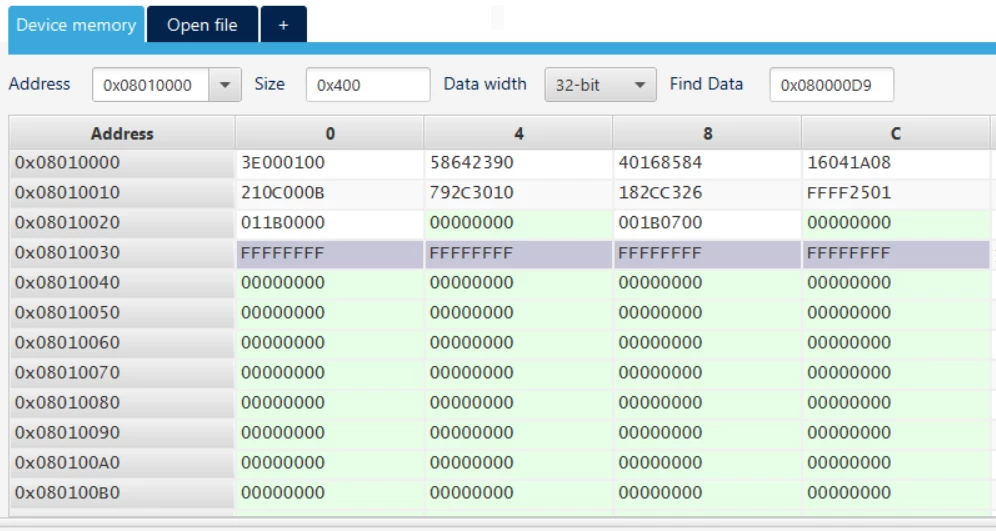

Here is the data I saved in bank2 page512:
Here is the data stored in flash bank1 page0:
0693W00000Lz2JGQAZ.pngThis is the data I am reading:

As you can see, underlined values not are only wrong but they belong to data in the page0 and I don't have any idea how the iteration can fetch these values out of the range of the address.

  5. why 0x08000010-2c and 0x08010010-2c have same values(check where you are writing gps data)

From your screenshot, ALL of the values match up with values in 1, not just some. Some of them happen to be the same in both banks.
