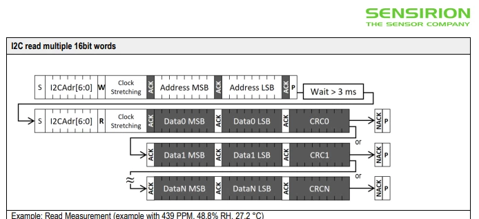

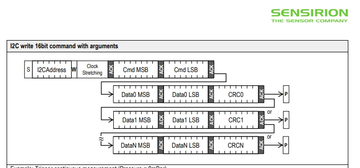

here is the link to the sensor and here is the link to the protocol document. I found another person's example code and took the 12 byte buffer from that. if you look on page 8 of the linked SCD30 document, using the HAL i2c function, I would be sending 5 bytes of data, CRC included. I think that's the part that's messing me up. I haven't been able to reproduce the example CRC with any calculator or example code and this MCU does not have integrated CRC functionality.

The transmit is only 11 bytes of data: the I2C Address is specified separately - not included in the buffer:
For receiving, it's (up to) 9 bytes of data:
The sensor datasheet shows example scope traces - compare them to what you're seeing.
