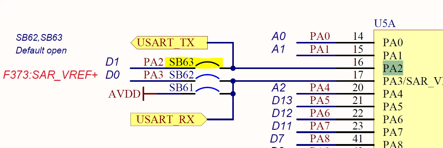

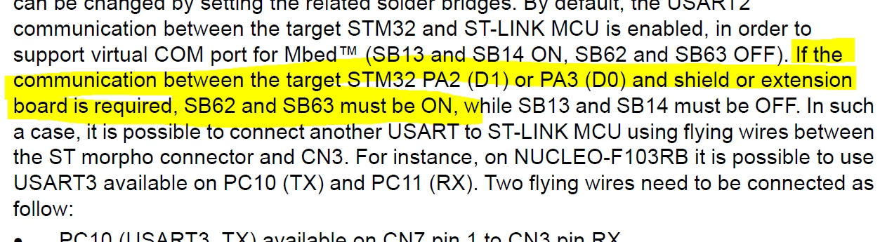

In this case, the most likely explanation is that SB63 isn't closed, so D1 isn't connected to PA2.

So it seems that there is no way to use use the ADC3 through D0 or D1 without making hardware changes, correct? Also, I am using the nucleo board to prototype before transferring code to our custom PCB. In the case of the stm32 chip on the PCB, I am thinking this would not be an issue since it looks like this setup is specific to the nucleo board?
AP.10
AP.10Author
Oct 20, 2021 6:15 PM UTC
Also I should mention I got it to work using pin PC3 on the Nucleo board, which confirms that pins PA2 and PA3 do not seem to be connected to D1 and D0 as you mentioned. So thanks for clarifying that!
