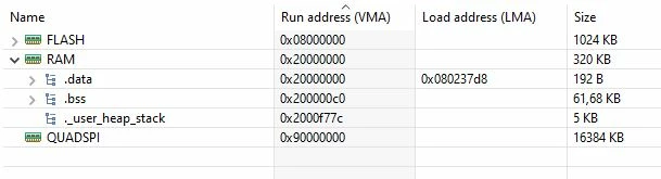

I'm using a STM32F746G-DISCO and I write my own Graphic Lib.
Now I want to put the bmp icons into the QSPI Flash.
What I've done....
  • Linker file is changed
 MEMORY
 RAM (xrw) : ORIGIN = 0x20000000, LENGTH = 320K
 FLASH (rx) : ORIGIN = 0x8000000, LENGTH = 1024K
 QUADSPI (r) : ORIGIN = 0x90000000, LENGTH = 16M
 .iconqspi :
 . = ALIGN(4);
 _qspi_start = .; /* create a global symbol at qspi start */
 *(.iconqspi) /* iconqspi sections */
 *(.iconqspi*) /* iconqspi* sections */
 . = ALIGN(4);
 _qspi_end = .; /* define a global symbols at end of iconqspi */
 } >QUADSPI
and in the end....
.iconqspi : { *(.iconqspi) } >QUADSPI
In the BuildAnaylzer you can't see the sections.

But the Build Analyzer tells me that there's no data in the QSPI Flash.
What is my mistake ?
