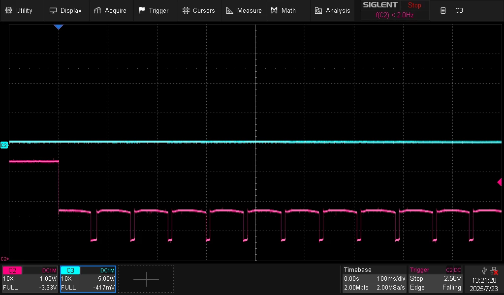

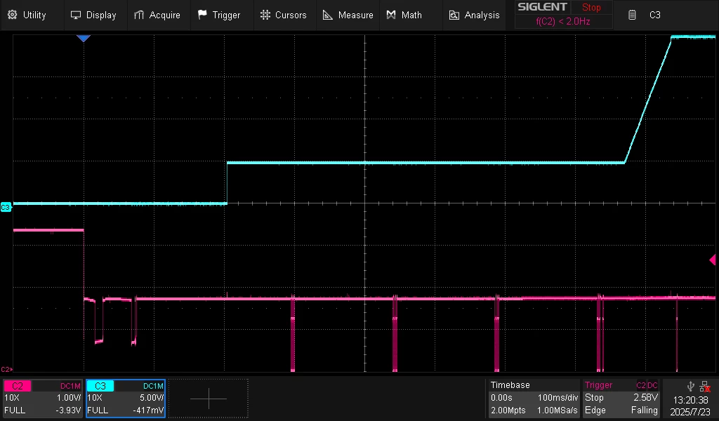

When connecting the USB PD supply the CCx line is pulled down and after it is stable for 100ms - 125ms (depending on the power supply) the 5V are provided. When microcontroller is running, the UCPD is requesting 20V and this usually works.
Here is a osci screenshot of a working negotiation (C3 is the Vbus voltage, C2 is the CC line voltage):
BUT sometimes the negotation fails in the early stage. The USB PD source will not provide 5V.
According to the standard the CC line must be stable for > 100ms. Right after connection the voltage falls from 3.3V to 1.65V (due to the Rp/Rd resistors). Then there is a further drop after ~60ms which will appear periodically every ~100ms. Sometimes after 10s or longer the drop is missing and the charger will provide 5V. What could be the problem?

  • I could not reproduce it on a NUCLEO-G474RE (other type/package, hooked up USB C connector via breakout board). I also see one drop, but after that CC is stable and the source is providing 5V
  • It seems that one connector side works better than the other (flipping the connector 180°)
  • Using external 5.1kOhm resistors for pull downs on cut the CCx/DBCCx connection works fine on the eval board (no voltage drop)
Has anyone seen this behavior? What could be the problem? Why is the microcontroller periodically "droping the voltage" (basically it uses a lower resistance or draws an additional current)?

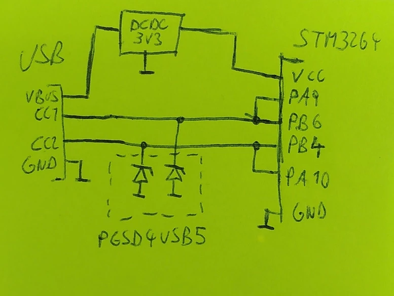

Would you share schematics? you can refer to schematics for SINK application provided here as reference.
To give better visibility on the answered topics, please click on "Best answer" on the reply which solved your issue or answered your question.Best regards,FBL
August 6, 2025
I can't provide the complete schematic, but here is the relevant part. The pins CC1/CC2 are directly connected to the STM32G4. A ESD protection (Nexperia PESD4USB5BTBR-QX) is used. I unsoldered the ESD protection, but this does not make any difference.
