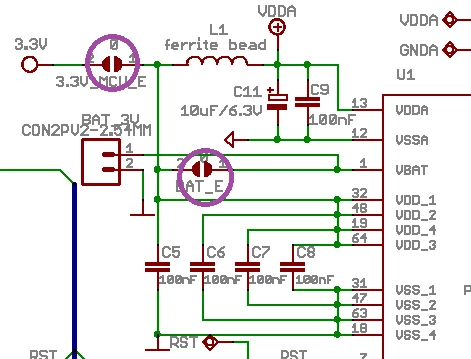

    The specs are for the chip, not the board.
    Are you measuring the current on the 3-3V3 supply for the chip itself, or prior to the regulator and for other chips (RS232 buffer, etc)?

    The current drawn by VBAT will be of most interest as the internal regulator should switch off in STANDBY.
    From my own F1 design I recall drawing 180 uA from my lithium battery (3.7V) in STANDBY, and in STOP it was below 1mA (800-900 uA). This was a board designed to be able to turn off and be low power, not some random board from the internet.
    You need to consider what else on your board is pulling current, and be able to break the supplies to the F1 itself to quantify what it is using vs the rest of the design. I'm not sure if the Olimex board was designed with that much consideration.

    You need to be measuring the current of the STM32 at the solder bridges on the board that break the supply feeds to the part.
    You also want to be sure you're getting the part into STANDBY, and perhaps add code so you can identify that you RESET out of STANDBY successfully on the other side.
