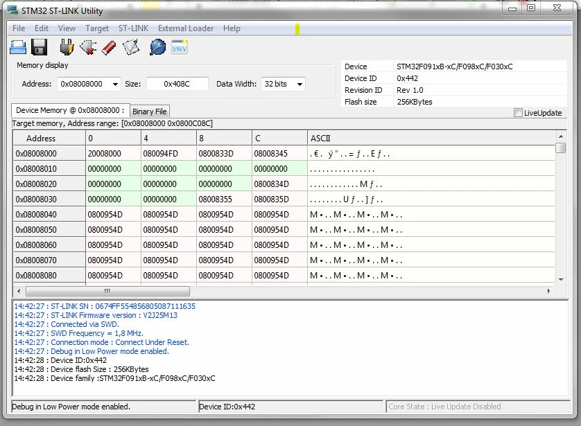

    My simple application consist of blinky a led. when bootloader jump to application, I can see
    that it work perfectly. I also check memory register and compare it with .hex file ( everything is ok).

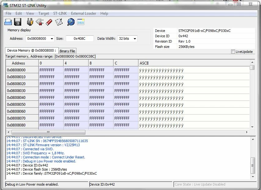

    So, the problem is when i power down my board and restart it, i can see through
    st link utility, memory register empty.
    here before reset

    Well it is going to fail the stack pointer check with 0xFFFFFFFF in the base vector. ie it's not pointing to 0x2000xxxx so the sanity check doesn't allow it to call the application.
    You need to review what code you have in the loader or the application that can erase the flash. Instrument that, and understand why/how it is called/used.
