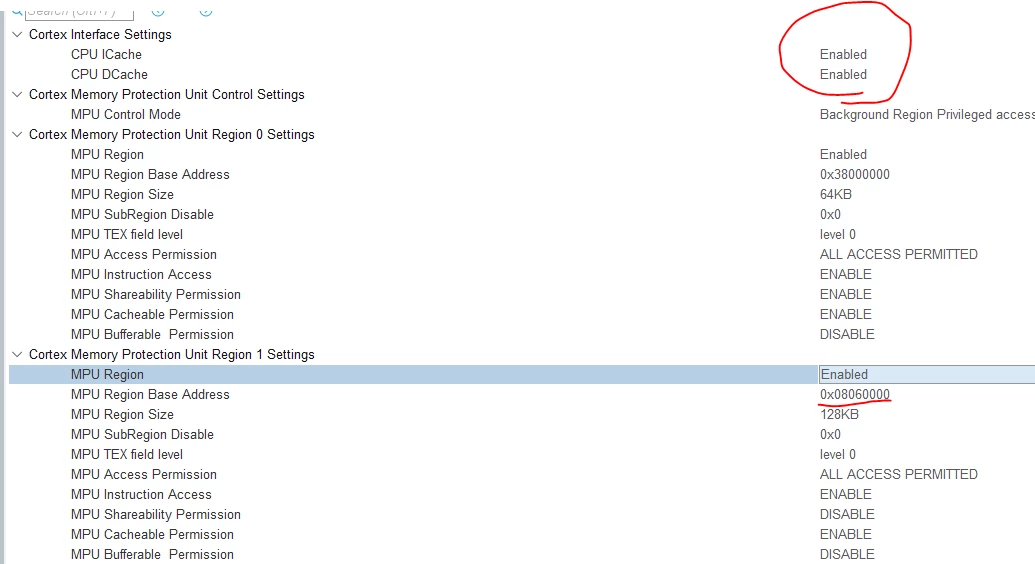

Cache is enabled, MPU is configured below

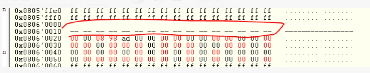

0693W00000JMSgUQAX.pngAfter at first writing 44444(0xad9c) , writing same value (44444) in same address , everything works well
But I have problem in writing different value(44443) in same address
this is state of memory after writing 44444(0xad9c)

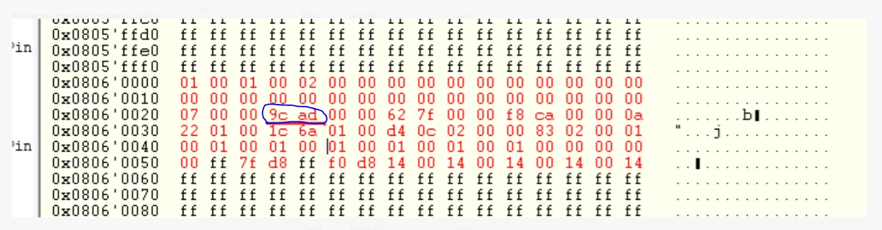

0693W00000JMShwQAH.pngand this is state of memory after writing 44443 which is different value than before.
0693W00000JMSkRQAX.pngMemory is changed strangely .

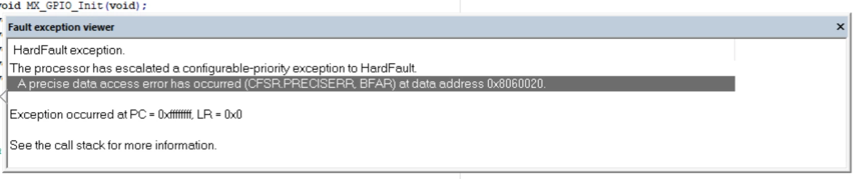

since this, reading of the value will result in an error.

Because the Flash lines are wide, have ECC, and cannot be written multiple times, even if just knocking down bits.
I​f you want to change content expect to Erase first. Consider journalling data over subsequent words.
