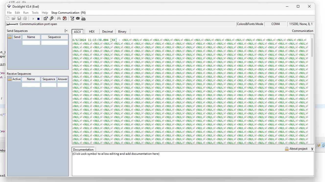

Problem in transmitting character over UART using STM32L476RG EVB
I am trying to transmit character over USART2 using STM32L476RG EVB. I am getting "NUL" at the debug terminal instead of the transmitted data. please help. Here is the code and debug terminal:Debug TerminalDebug Terminal

June 12, 2024
Thank you for your replay.
Using STM32CubeMX and HAL functions, UART data transmission and reception are successful. However, when attempting to implement the same functionality with bare-metal coding, data transmission and reception fails. Initially, I attempted to use a baud rate of 115200 bps and subsequently tested several other baud rates, but observed no difference in performance. Is this suggests there might be an issue with the BRR value calculation.
Please help.
