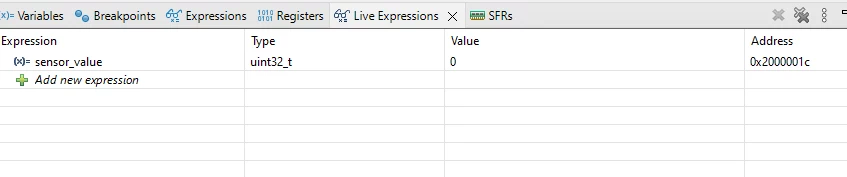

Problem in single conversion mode in ADC
While implementing a single conversion process for the Analog-to-Digital Converter (ADC) via register-level programming, the debugging phase yields a consistent output of zero, irrespective of the input. This anomaly persists even after the ADC input pin PC0 is alternated between a ground (GND) connection and a 3.3V supply, indicating no variation in the output value.
I am using Nucleo-L476RG evaluation board.
Please help.
