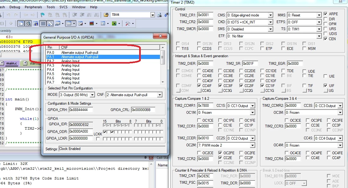

I am not able to  get PWM output on  timer output channel 2 ( GPIOA1)  after configuring general purpose timer 2 of STM32F103c8T6 Micro-controller in PWM mode 2.
My Configuration:
Timer :              General Purpose timer 2
Timer Clock:     72 MHz
Duty cycle:        50%
Frequency:       50 Hz
MCU crystal :   8 MHz
I configured the GPIOA in Alternate function output Push Pull mode with maximum frequency not exceeding 50 MHz,  I connected an LED bulb to the GPIOA pin 1, but the LED wend on glowing without reduction in the brightness level. The LED was still glowing even after i performed a test with duty cycle set to 0. On the debugger window I could see exactly all the parameters I configured and the Count register was getting incremented. I cannot find information regarding selection of alternate functions for a GPIO Port.

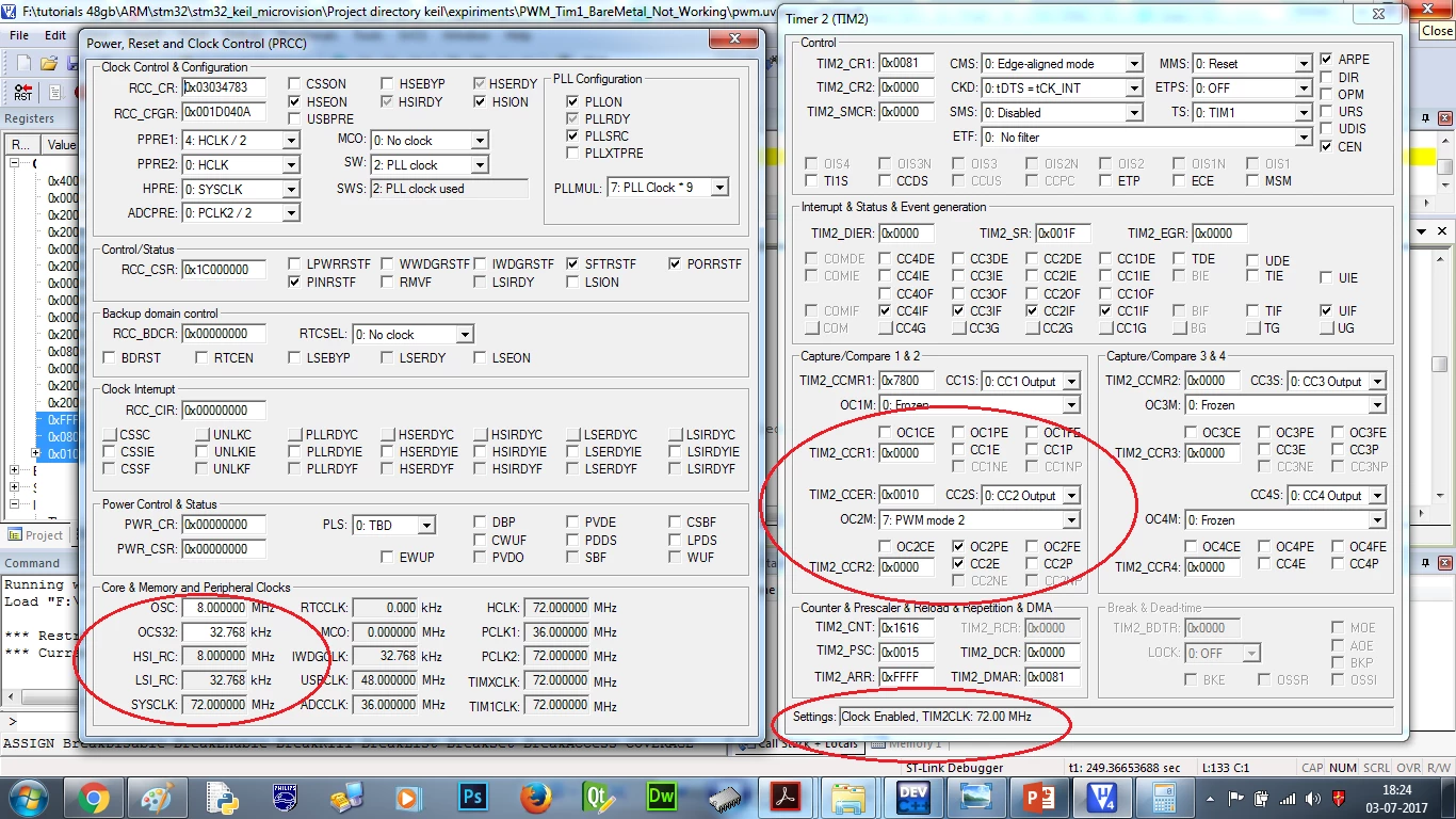

    What I don't see in your code is the configuration of the MCU clock.
    If you are mentioning about system core clock, it has already been set to 72 MHz inside the header file ''stm32f10x.h ''
    The timer clock is also 72 MHz only because the clock branching to timer 2 from APB1 has a multiplier.
    I could see that in the debug Window.
    Also here is the view of the GPIOA peripheral block:
    I couldn't find any clock setting mistakes.

    Mike Burmeister
    Mike BurmeisterBest answer
    July 3, 2017
    Posted on July 03, 2017 at 15:49
    Because you are using PWM2 which means the pulse is negative instead of Positive with PWM1, if you set the counter to zero the pin stays in the high state which will leave the LED turned on.  At 50% which is 32767 you may not see the LED blink as it is too fast.  You may want to try 65500 as a value and see if dims at that level which leaves the pin low.
    Mike
    Rakesh Menon
    July 3, 2017
    Posted on July 03, 2017 at 16:15
    Hello Mike,
    Yeah that's write, I did changed the value to 65000, and I saw the LED getting less brighter, and I did tests with values ranging from 65000 to 65530 in a for loop, and now the change in illumination level is clearly visible.
