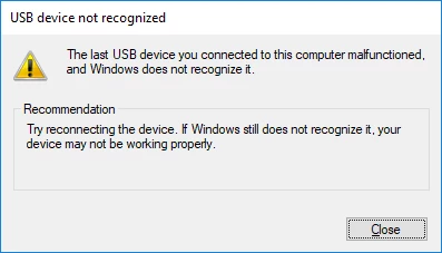

Problem in MSC_Standalone, STM32F4
When I compile and download the code. I see a USB problem.
What could be the possible solution ?

Pavel A.
Aug 29, 2018 9:53 PM UTC
It is USB enumeration error. Win10 usually displays better/more detailed reason than older versions so try it.
Debug the USB code on the STM32 side to get to the root case.

I have already used Win10.
Which I should pay attention in the STM code side ?
Tesla DeLorean
Guru
Sep 3, 2018 2:44 PM UTC
The descriptors might be a good starting point?
Make sure your clock, PLL, and HSE_VALUE sets are correct.
Make sure the stack and heap sizes are sufficient.
Instrument your code to see what interactions are occuring, and where things stop functioning.
