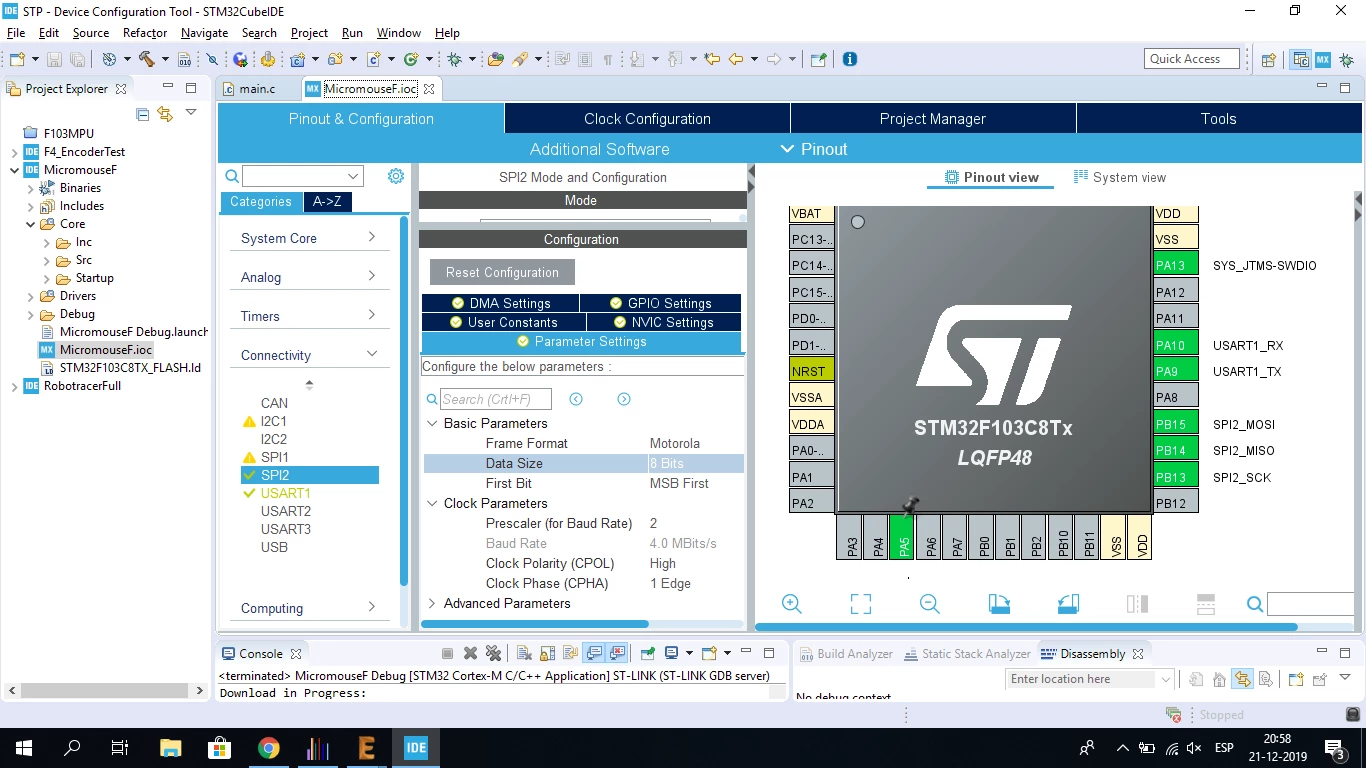

Problem geting SPI values
Hello Everyone!
I have some problem using SPI comunication between my STM32F103C8, and the angle sensor MA730.
I get by separated the first 8 bit data and the second 8 bit data with de HAL_SPI_Transfer function, and looks like fine, but i get not values between 64 and 192 in the first 8 bits data. (See the video).
I don't think that is a hardware problem, because i have not problem when i get values with arduino.
What may be the problem?
Thank you!!

SPI_HandleTypeDef hspi2;
UART_HandleTypeDef huart1;
/* USER CODE BEGIN PV */
uint8_t Data_Input[] = { 0x00, 0x00 };
uint8_t Data_Output[2];
uint8_t buffer1 = 0;
uint8_t buffer2 = 0;
/* USER CODE END PV */
static void MX_SPI2_Init(void);
static void MX_USART1_UART_Init(void);
/* USER CODE BEGIN PFP */
/* USER CODE END PFP */
/* USER CODE BEGIN 0 */
void get_vel() {
	volatile uint8_t dummy;
	hspi2.Init.CLKPolarity = SPI_POLARITY_HIGH; // CPOL = 1
	HAL_GPIO_WritePin(CS_ENCL_GPIO_Port, CS_ENCL_Pin, 0);
	HAL_SPI_TransmitReceive(&hspi2, (uint8_t*) Data_Input,
			(uint8_t*) Data_Output, 2, 100);
	HAL_GPIO_WritePin(CS_ENCL_GPIO_Port, CS_ENCL_Pin, 1);
	buffer1 = (Data_Output[0]);
	buffer2 = (Data_Output[1]);
	HAL_GPIO_TogglePin(LEDW_GPIO_Port, LEDW_Pin);

 hspi2.Instance = SPI2;
 hspi2.Init.Mode = SPI_MODE_MASTER;
 hspi2.Init.Direction = SPI_DIRECTION_2LINES;
 hspi2.Init.DataSize = SPI_DATASIZE_8BIT;
 hspi2.Init.CLKPhase = SPI_PHASE_1EDGE;
 hspi2.Init.NSS = SPI_NSS_SOFT;
 hspi2.Init.BaudRatePrescaler = SPI_BAUDRATEPRESCALER_2;
 hspi2.Init.FirstBit = SPI_FIRSTBIT_MSB;
 hspi2.Init.TIMode = SPI_TIMODE_DISABLE;
 hspi2.Init.CRCCalculation = SPI_CRCCALCULATION_DISABLE;
 hspi2.Init.CRCPolynomial = 10;
 if (HAL_SPI_Init(&hspi2) != HAL_OK)
 Error_Handler();

For test, add a delay after your transmit receive function, any change?
2 replies
S.Ma
S.MaBest answer
Principal
Dec 22, 2019 7:36 AM UTC
Andres Bercovich
Dec 22, 2019 2:26 PM UTC
:face_screaming_in_fear:
It worked!
It seems that the CS signal was rising before the end of the transmission. I added a little delay and it works smoothly.
void get_vel() {
	volatile uint8_t del = 0;
	for (uint8_t i = 0; i < 15; i++) {
		del++;
	del = 0;
	buffer = (Data_Output[0] << 8) + (Data_Output[1]);
