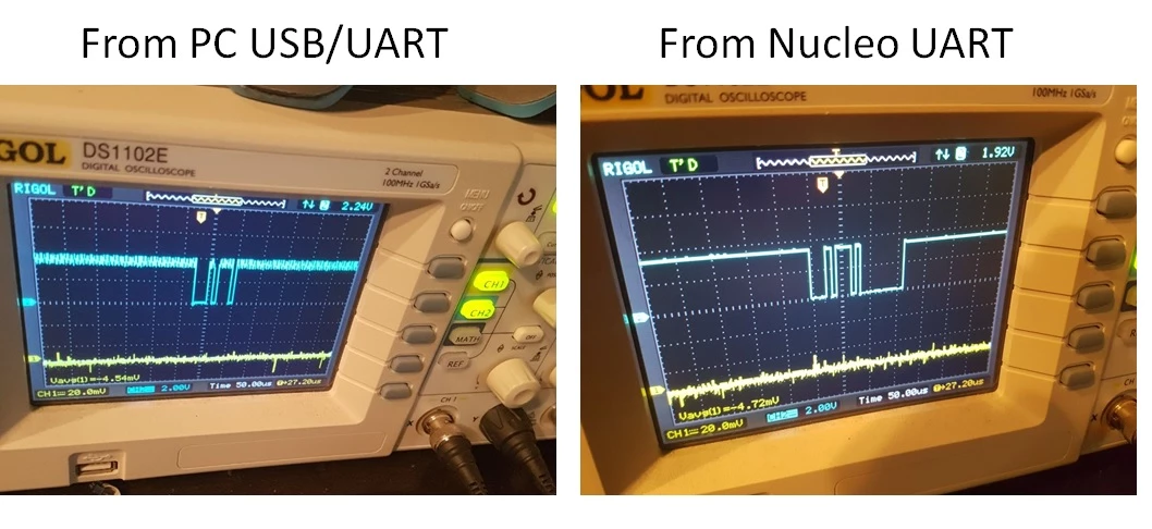

Problem connecting a STM32 Nucleo (F401RE) to a ESP8266 via UART. (uart channel sends extra '0's)
I am try to connecting a STM32 Nucleo (F401RE) to a ESP8266 on UART.
I've managed to control the ESP8266 with the PC using a usb/uart channel and hyperterminal.
I've managed to send uart messages to the PC from the Nucleo
But I am unable to command the ESP8266 from the Nucleo, the same commands that worked sent from my PC, do not work sent from the Nucleo.
I've sent a simple char 't' just to see how it looks on the scope from both PC and Nucleo to comapre, and Im attaching my measurements, There is a difference between the usb/uart device and what the Nucleo sends, an Endian, it seems the Nucelo adds some '0' and I suspect this might cause the problem.

Show your code that actually sends the data from the Nucleo. I bet it looks something like this:
char cmd[] = "t"; // This is actually 2 bytes, 't' and '\0'
HAL_UART_Transmit( huart1, cmd, sizeof(cmd) ); // therefore, sizeof() is 2

You sir are a national treasure of whatever nation you belong to.
Now it is working.
