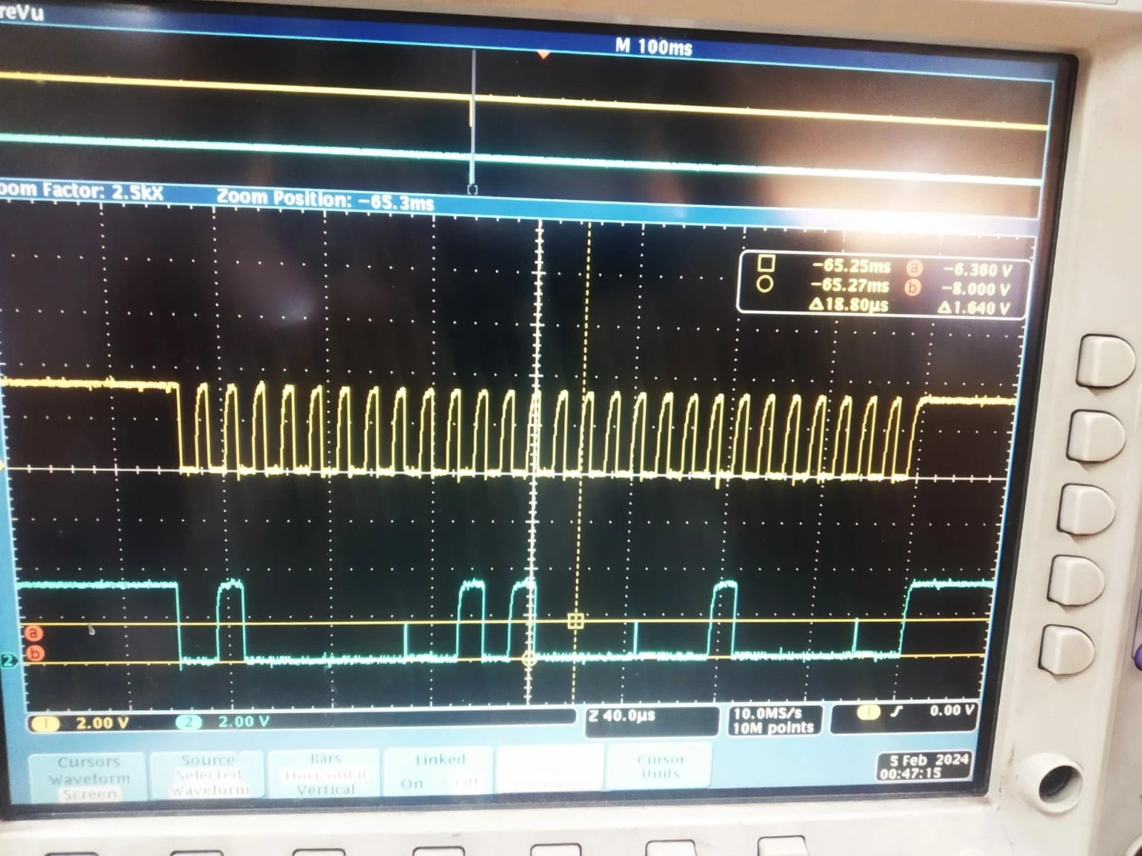

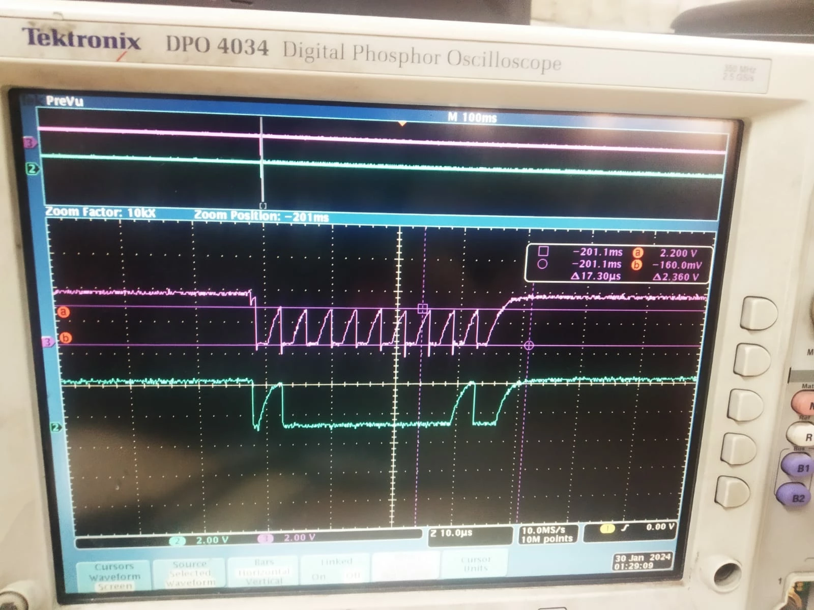

I am facing problem in configuring my board in I2c protocol. When  i configured the same board in standard mode it is working fine. Rest of the settings for pins(pull-up) ,rise time and fall time are same in both the files.
Also attaching waveforms for both the mode. Can anyone suggest me what can be done to make the board work in fast mode as well.

The pullup resistors on the SDA/SCL lines are insufficient for fast mode. Replace them with lower valued resistors. 2.2 kOhm is typically fine.
