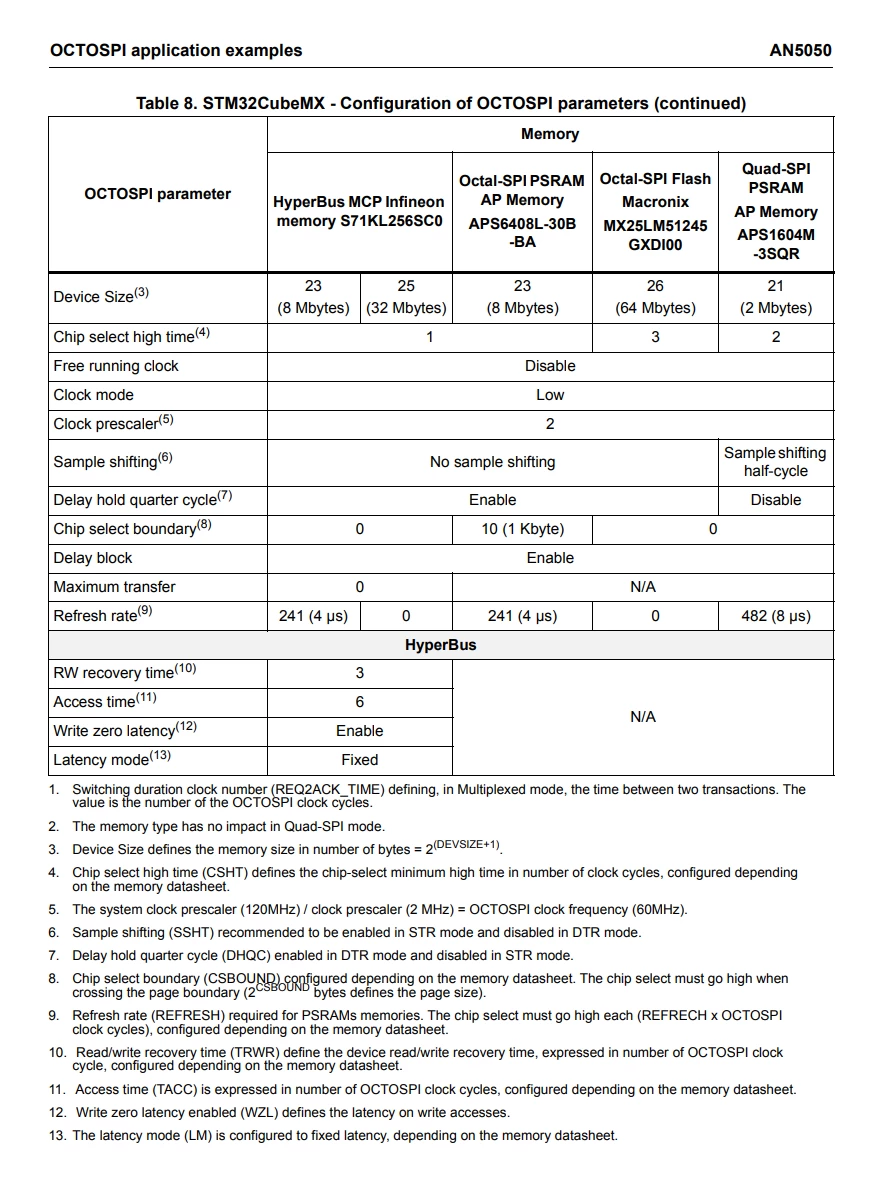

Is the delay block enabled or disabled?
Could you please refer to AN5050 table 8. and check your OCTOSPI configuration.
Please take a look at Help needed for tuning 64Mb HYPERRAM (S27KL0642DPBHI020) on STM32H735IGT6 discussion may help you.

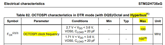

Also could you please try to decrease the OCTOSPI frequency:
Thank you.
Kaouthar
October 23, 2024
The device we are using is: https://www.infineon.com/dgdl/Infineon-S27KL0642_S27KS0642_3.0_V_1.8_V_64_Mb_(8_MB)_HyperRAM_Self-Refresh_DRAM-DataSheet-v09_00-EN.pdf?fileId=8ac78c8c7d0d8da4017d0ee8a1c47164
I will try reducing the frequency, however we are not using either PC2 or PC3 for the interface

> #define OCTOSPI_HYPERRAM_LATENCY 6
This is definitely wrong, check the memory's datasheet.
Just looking quickly over it, it seems latency is always 4 cycles for writing, also for reading, but for some readings an additional 4 cycles (don't know when, don't know how to set this in OCTOSPI).
Check RM: OCTOSPI HyperBus latency configuration register (OCTOSPI_HLCR)
