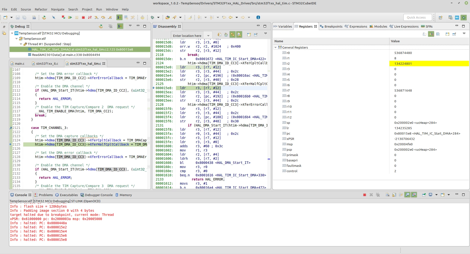

nowave7
nowave7Author
December 9, 2019
Thank you kindly for the reply Jan.
After running the debugger in mixed mode with instruction stepping mode on, I can see that the interrupt always occurs on the same instruction:
2125      htim->hdma[TIM_DMA_ID_CC3]->XferHalfCpltCallback = TIM_DMACaptureHalfCplt;
080015e8:  ldr   r3, [r7, #12]
Oddly enough, the same instruction was executed for the previous C statment:
2124      htim->hdma[TIM_DMA_ID_CC3]->XferCpltCallback = TIM_DMACaptureCplt;
080015e0:  ldr   r3, [r7, #12]
and there was no problem at all.
I've attached an image with the listing of both C and asm code, and the contents of the registers right before executing the instruction in question.
