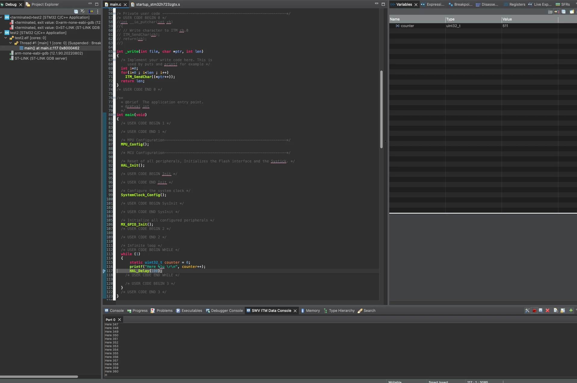

After few successful printing using printf and the SWV ITM data console, the console stops showing new data.
To recreate, I created new project, selected the device I have (STM32H723ZGT6), followed the instructions to enable debugging via printf/SWV ITM and run a sample program that just print every 100msec.
As you can see in the screenshot, the prints halt after 360 lines, although the program still runs and I can place an interrupt and see the program and the counter still progress correctly.
Any idea what can cause the printf to stop working?
