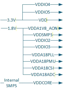

I am designing a custom board based on the STM32N657X0H3Q, using the STM32N6570-DK as a reference. The MCU is configured to use the internal SMPS for VCORE generation.
Unfortunately, my design does not fully comply with the recommended power sequencing described in the documentation:
  • The various 1.8 V rails are generated from a single DC/DC converter.
  • VDDA18USB, VDDA18CSI, and VDDA18ADC are powered directly from this 1.8 V rail.
  • These rails are not gated by PWR_ON and therefore may become valid before or simultaneously with the PWR_ON assertion.
The MCU appears to boot and operate correctly during initial testing, but I would like to understand the implications of this deviation from the recommended power sequence.
My questions are:
  1. Does powering VDDA18USB, VDDA18CSI, and VDDA18ADC before (or independently of) PWR_ON create any risk of device damage or reduced reliability?
  2. Are there any known functional issues that could occur during startup, shutdown, or brownout conditions?
  3. Is this configuration considered acceptable when using the internal SMPS, provided all voltages remain within the specified limits?
  4. Has ST characterized or tested configurations where all 1.8 V domains are powered simultaneously from a common regulator?
Any guidance on the expected impact and long-term robustness of this power architecture would be greatly appreciated.
Thank you.

Hi ​@IMor.1
The STM32N6 hardware getting started guide specifies that auxiliary supplies, including the optional analog, CSI, and USB supplies, power up after PWR_ON rises. Powering these rails earlier does not follow the recommended sequence. Please follow the documented sequence; otherwise, ST cannot guarantee device behavior.
