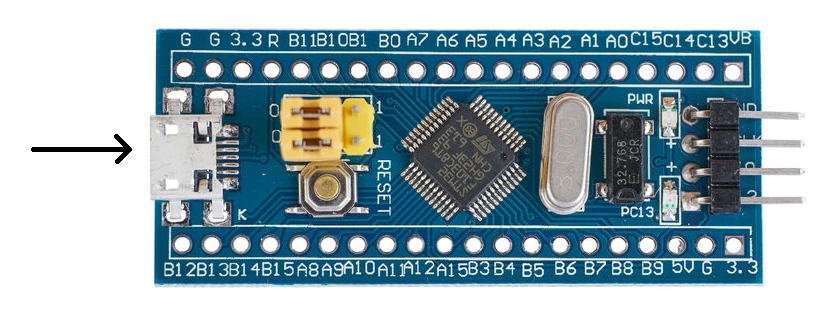

Hello, I've a strange problem and I can't find the answer on internet.
0693W00000Y9jo0QAB.pngI'm transmitting a data from UART2 of my STM32 Blue pill.
Its just one line :-
HAL_UART_Transmit(&huart2, (uint8_t*)Tx_msg, sizeof(Tx_msg), 100);
While using with ST-Link, it works.
When i connect micro usb from my laptop to Bluepill, it also works and transmits the data,
But when i connect micro usb from 5V charger/adapter to Bluepill, it doesn't work.
Bluepill is powered because LED is glowing but data isn't transmitted.
I tried with various chargers of different power, but it doesn't work.
Am i missing something?

Check the GND connection between the BluePill and whatever you transfer the data to.

Hello @gbm​ , thank you
