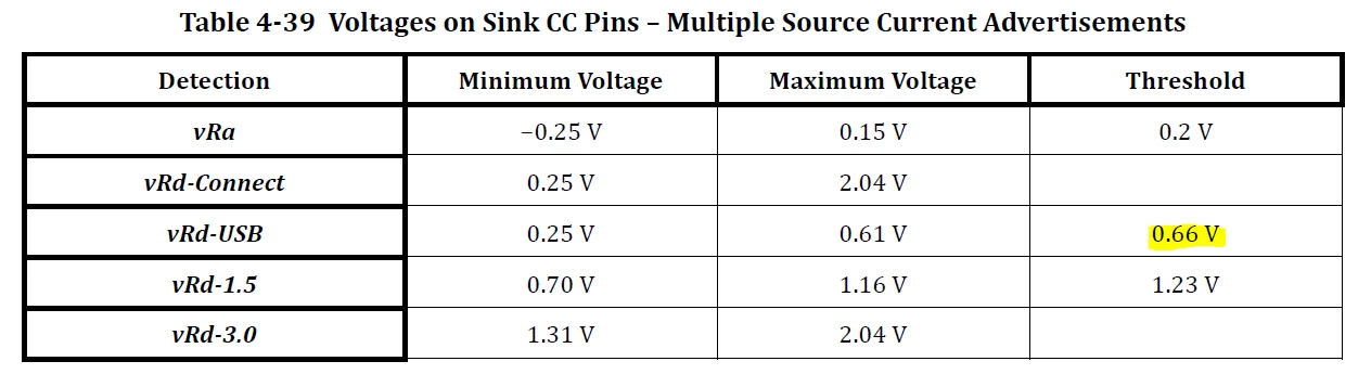

Thanks, Let me repharase the question properly. There are 2-USB type-C ports which supports (USB 3.0 to USB-PD cables). Max load is 5V @1.5A. Along with the reverse protection devices for limiting the in-rush current, Do I need some USB controller IC after the USB-type-C port for the CC-pins. One of the USB port will be used for Communication purpose and power will be taken from both the USB ports and ORING will be done. Any reference design for Dual port type-C in UFP mode-sinking current. along with protection ckts will be helpful. The USB signals will then be interfaced to STM controller.

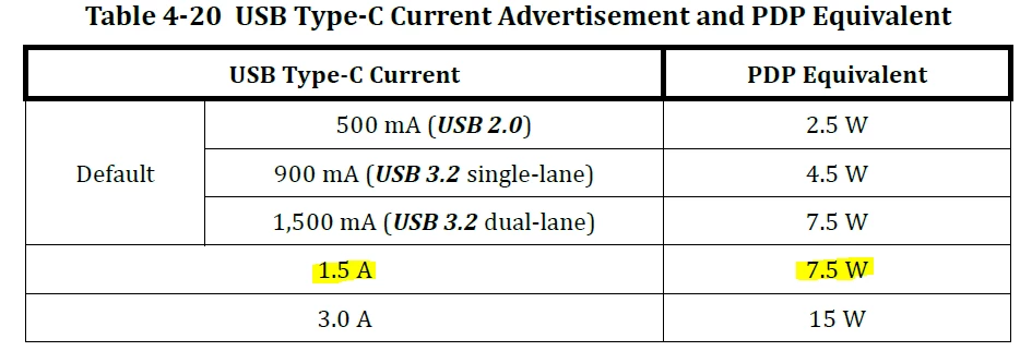

You are looking for basic Type-C SINK with 1.5A max without Power Delivery (STM32U0 series).
Legacy current on USB-C VBUS is 5V 0.5A when VBUS turns-on.
The system must be able to start below this current threshold.
Once started, system senses SOURCE capability (0.5A or 1.5A or 3.0A).
It is done thanks to voltage on active CC line (>0.66V on 5.1kΩ)

  • 1 time : 0.5A
  • 2 times : 1.5A
  • 3 times : 3.0A
