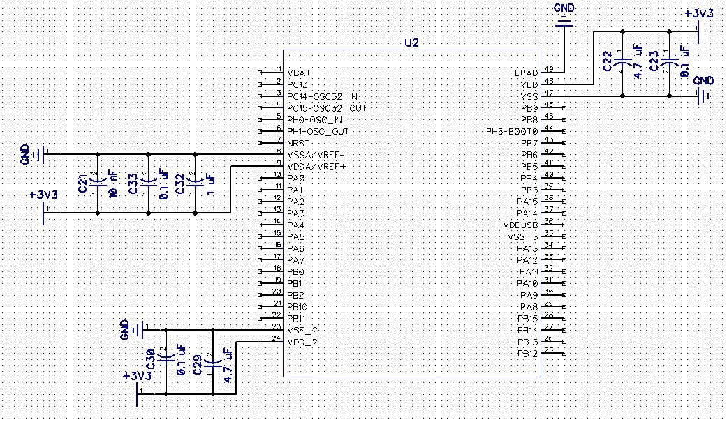

I'm doing the schematic design for a circuit board using the STM32L452CEU6.

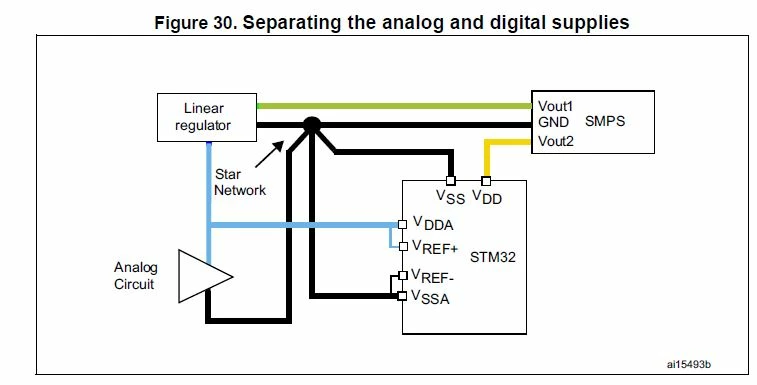

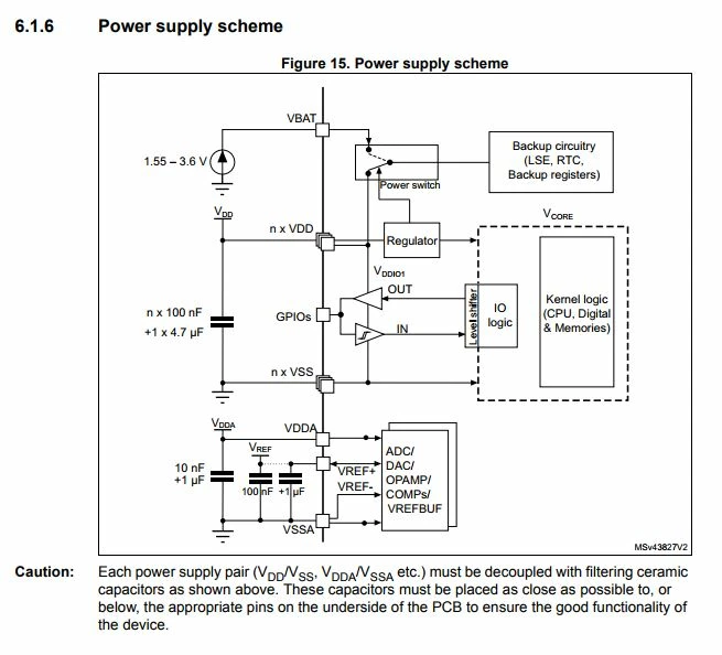

I find the power supply scheme to be a little confusing. I've attached the supply scheme from the datasheet as well as my schematic.
Is what I've done so far correct?

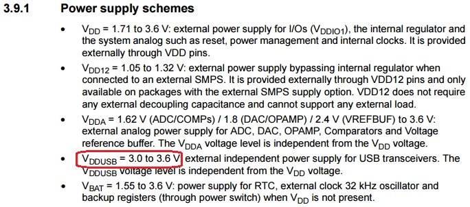

Do I treat VDDUSB and VSS_3 as just another VDD/VSS pair with a 4.7uF cap and 0.1uF cap on?
