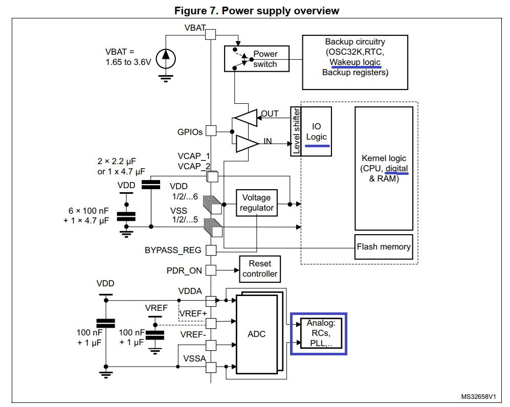

According to figure 7 page 71 :

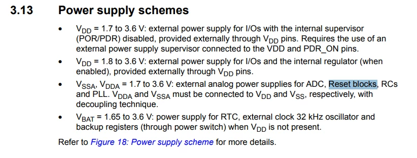

The analog domain is ADC , RCs and PLLs and .. etc , I would like to know a complete list of the rest of functionalities associated with the analog Domain , Even in DS9716 Page 18 section 3.13 third Bullet it specify a partial list of blocks but it includes “Reset Blocks”  , what does reset block refer to exactly can i conclude safely its the POR , PDR , BOR , PVD blocks exactly or that is not correct or partial .
Regarding digital domain the word “digital” does it mean “Digital peripherals” ?
Why “IO Logic” different  from “GPIO peripheral” being a part of digital peripherals ?

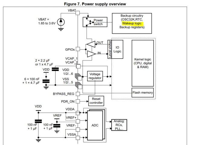

For VBAT , what is the functionality of “wakeup logic” and the difference to “standby circuitary” term .
The above inqueries/questions are just an example of some points that is not clear for me , but ideally i need just a small tree like diagram for power sources , with leaf nodes a list of functional compoents in a sharp clear way , if the category can’t be decomposed to a list if subfunctional levels (can’t be disclosed) I just need the functionality of what it does what are input and output as black box .

My goal to understand for each power pin (power domain Digital , Analog or VBAT ) what are peripherals or functional blocks powered from that pin / domain , I was reading the data sheet and came accross the following three terms :

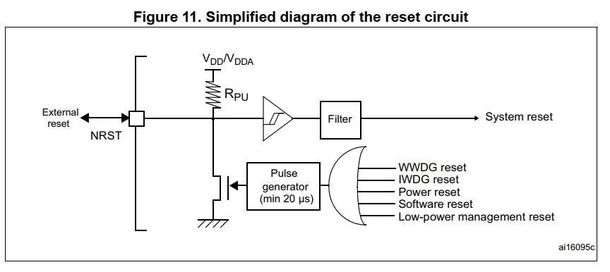

Reset Blocks (RM 5.2.1 , 5.2.2 , 5.2.3 ) , The confusion comes because I am not sure whether the intended menaning by that term is to refer to POR , PDR , BOR , PVD functional blocks (as reset sources) mentioned in the  power chapter , or to the reset circuitary mentiones in the following figures :

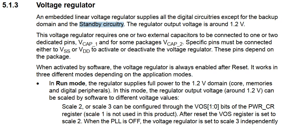

 The other two terms (Wakeup Logic , Standby Circuitary ) are mentioned in the same RM in the following two figures , the confusion for those two terms comes from the fact I feel they are related but but can’t understand the difference in functionality between the two terms :
