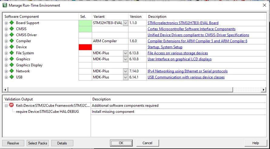

Also looking at the RTE configuration do you know why I get the RED block when I enable serial wire debug. For
JMors.1
Aug 17, 2020 9:57 PM UTC
Do you have a STM32H7B3i-EVAL board or a STM32H7B3i-DK (DISCO) board? It looks like you selected the EVAL board for the Board Support which will not work if you have a '-DK'.
onio
onioAuthor
Aug 17, 2020 10:22 PM UTC
Yes I am using STM32H7B3i-DK (DISCO) . I would change that and report back.
