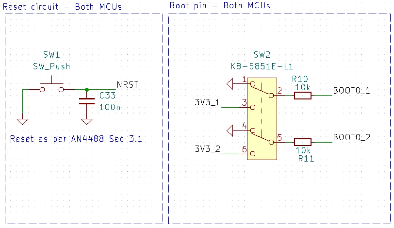

I am working on a board containing two STM32F412, and I am having a hard time reaching the DFU bootloader:
  • If I power off the board, pull the boot pin low, and then power on the board directly via USB, then cubeProgrammer is able to connect to the bootloader via DFU, completely as expected
  • However, if I let the board be powered in run-mode, pull the boot pin low, and then reset the MCU via the nRST pin, then the cubeProgrammer is not able to connect the bootloader via DFU

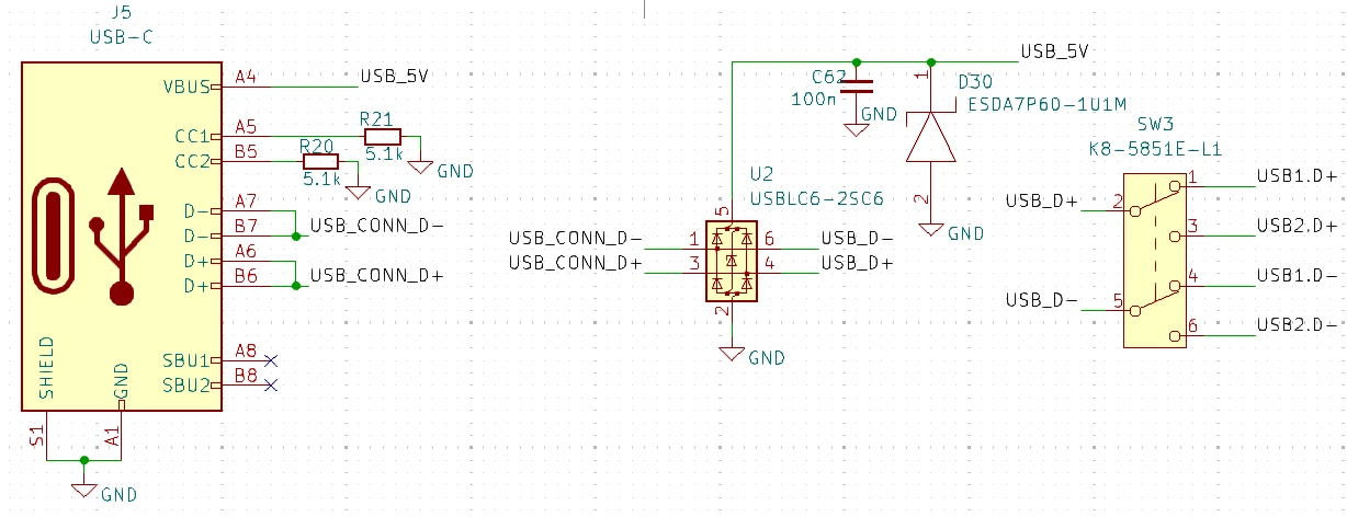

The schematic is illustrated below:
  • SW3 is a latching switch to select which of the two MCUs are connected to the USB connector
  • USB1.D- and USB1.D+ goes to PA11 and PA12, respectively on the first MCU, and USB2.D- and USB2.D+ and similarly connected to the second MCU
  • The design relies on the internal MCU pull-up resistors of the D+ line, as described on AN2606 (Table 72)
The reset and boot pin schematic is illustrated below:
  • The NRST signal is jointly connected to the reset pin on both MCUs
  • SW2 is switch that jointly asserts the boot pin on each MCU - Boot0_1 and Boot0_2 goes to Boot0 on MCU 1 and 2 respectively
The schematic is fully consistent with the design we usually use without issues, except for the details relating to having two MCUs instead of only one.
Any suggestions as to what might cause the issue we are seeing would be greatly appreciated.
mjuelsBest answer
October 30, 2024
I figured it out.
I had forgotten that BOOT1 is a physical pin on the F412 (PB2) - I had left it floating in my design, so the wrong boot mode is selected.

To elaborate on my issue:
  • My board can be powered either by a 24V supply, or directly by USB cable
    • In the description the description above, the board was only powered from a USB cable
  •  The presented circuit for resetting the MCU is used with great success on many of our other boards for entering DFU mode without doing a full power-on reset of the board
You mention that the USB PHY might not fulle reset with the NRST reset - Is there a better way to conduct a reset, or something else I could try?

I figured it out.
If I manually ground PB2 with a jumperwire during reset, the correct bootmode is selected, and the DFU kan be reached as intended.
