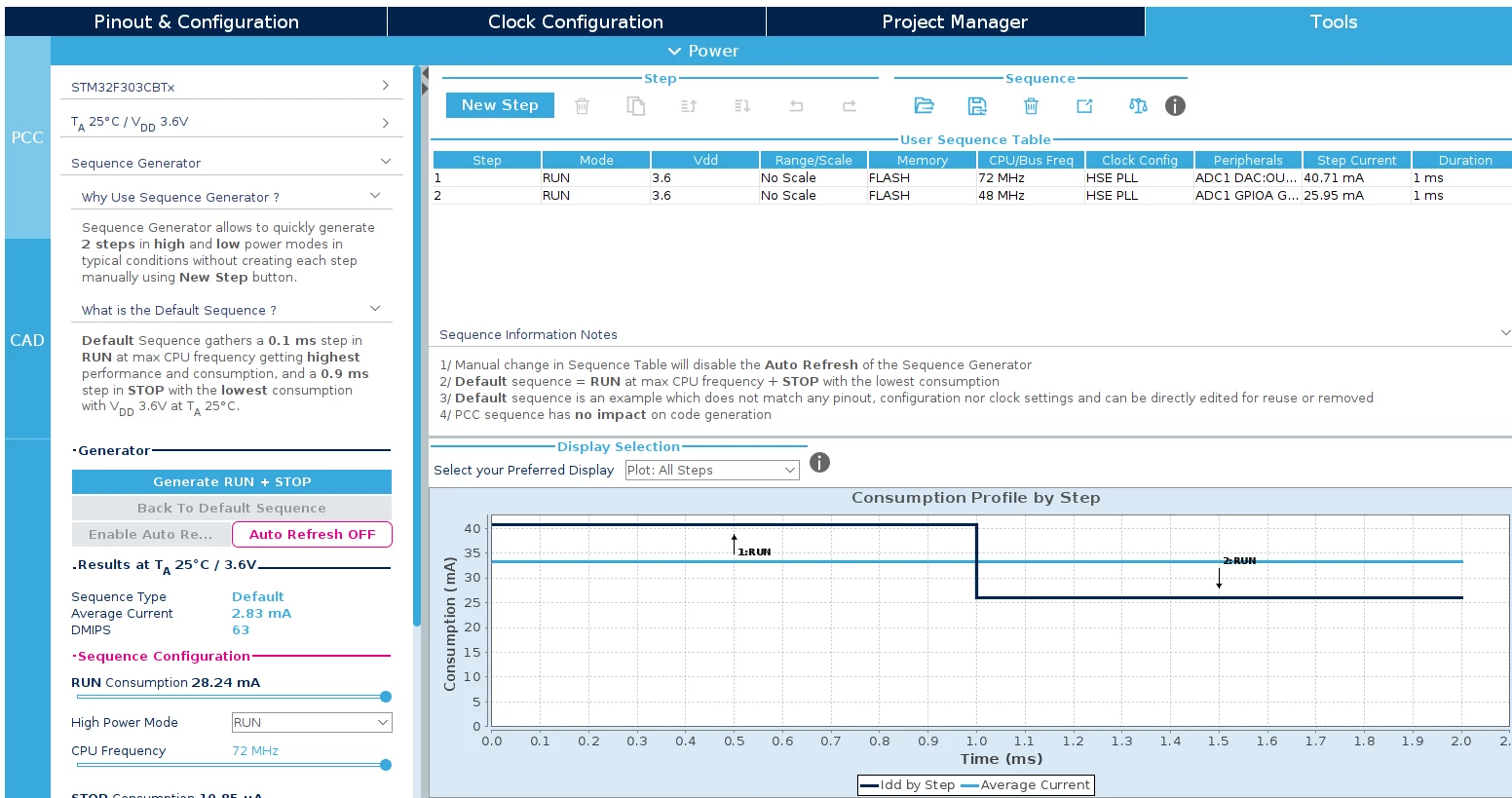

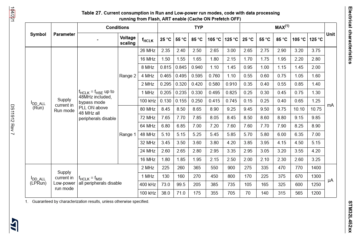

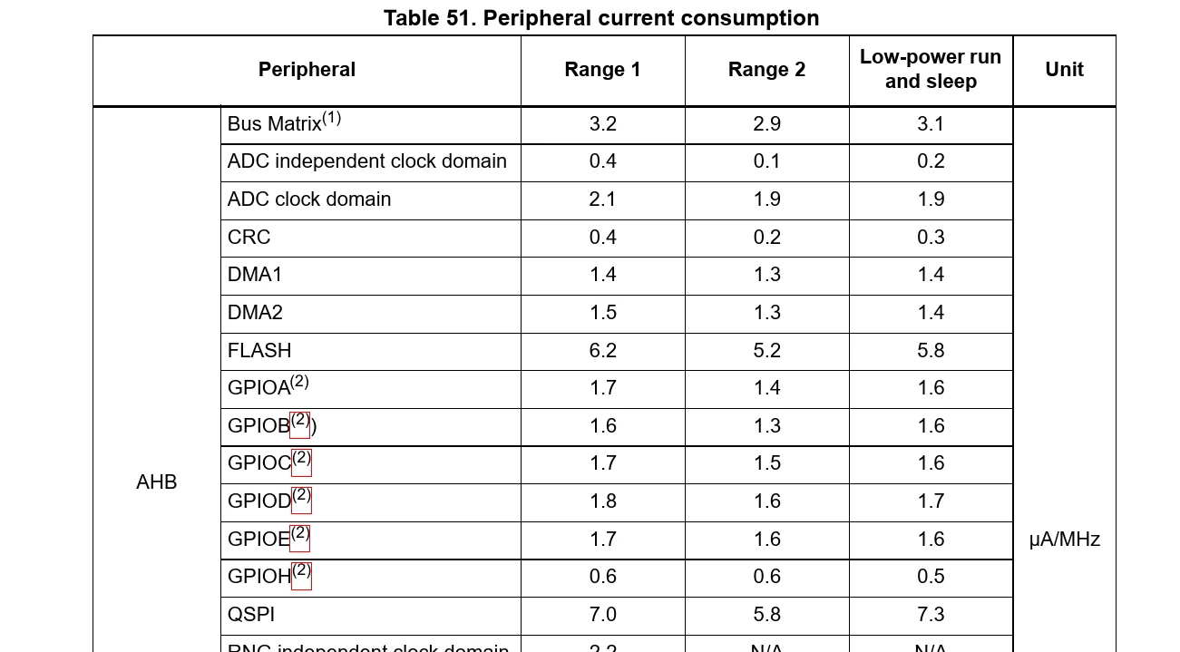

AScha.3
June 15, 2024
looking at ds of your chip might give information...
also for each peripherals..
+Check with power calculating tool in Cube, if you prefer ...
