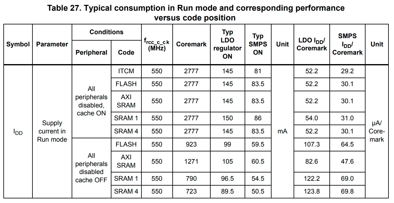

power consumption by STM32H735VGH on full speed ADC configuration
The total power consumption by STM32H735VGH at full speed interleaved mode differential adc configuration?
TDKBest answer
October 27, 2023
The datasheet has details about power consumption of various peripherals. It will depend on more information than you're providing, such as what other peripherals are active, what the clock speed is, cache settings, etc.
Generally, the processor will use tens to hundreds of mA and the clock speed has the biggest correlation to power draw. Low-power modes are also a possibility.
Here is one of many such power consumption tables from the datasheet:
And the datasheet:
https://www.st.com/resource/en/datasheet/stm32h735ag.pdf
