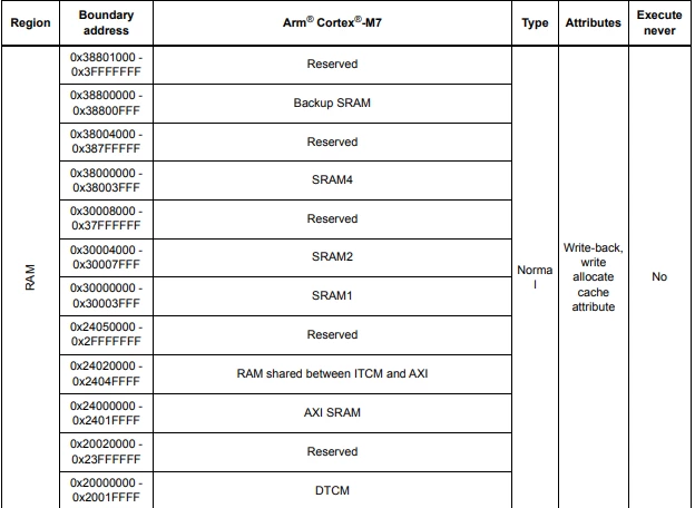

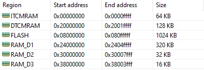

Hi All!
I am working with a STM32H723ZG. As shown in the pictures below this is the memory layout. However is it possible to increase the size of the RAM_D1 domain by reducing another domain? If yes, which domain/RAM can I take memory from to increase the D1 domain? I would assume it is done in the XXX_RAM.ld file? How much is it possible to increase it?
Best regards!

The Linker Script directs the Linker about where it can place things.
You can't change how the address decode hardware is wired. That's not how things work.
