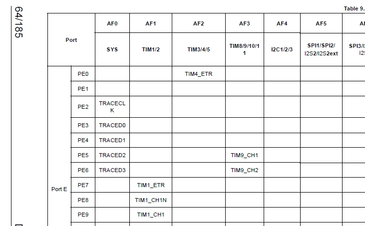

I am working on a sine wave program as a part of an Amateur Radio project.  I have a working code producing what I want using TIM3-- PWM and PORTC.  I am unfortunately unable to neither change the TIM3 to any other TIM nor am I able to change my PORTC to PORTE.  The code follows closely the PWM example by STM and Andrew Markham's approach to the interrupt handle.  I can post code, although I am not sure of the proper messaging protocol for code in this forum.  Since the code is working fine using TIM3 and PORTC, I would have thought that either change would have been a simple task.  I have of course tried to change only one at a time.  Changes compile fine with no errors;  but no output is found on the appropriate pin using an oscilloscope, except the TIM3/PORTC arrangement. Thanks for any help.

    You can paste source using the Format Code Block (Paintbrush [<>] icon). I want to see complete compilable code.
    Timers have specific pin utilization, so you can't randomly associate them. The part data sheet should show what routing options are available.

    PE2 has no timer associativity. Please refer to the
    http://www.st.com/st-web-ui/static/active/en/resource/technical/document/datasheet/DM00037051.pdf
    for your part.
    PE5/PE6 are TIM9_CH1 and CH2 respectively

    thanks for the reference pointer.  I will explore other possible combinations.
