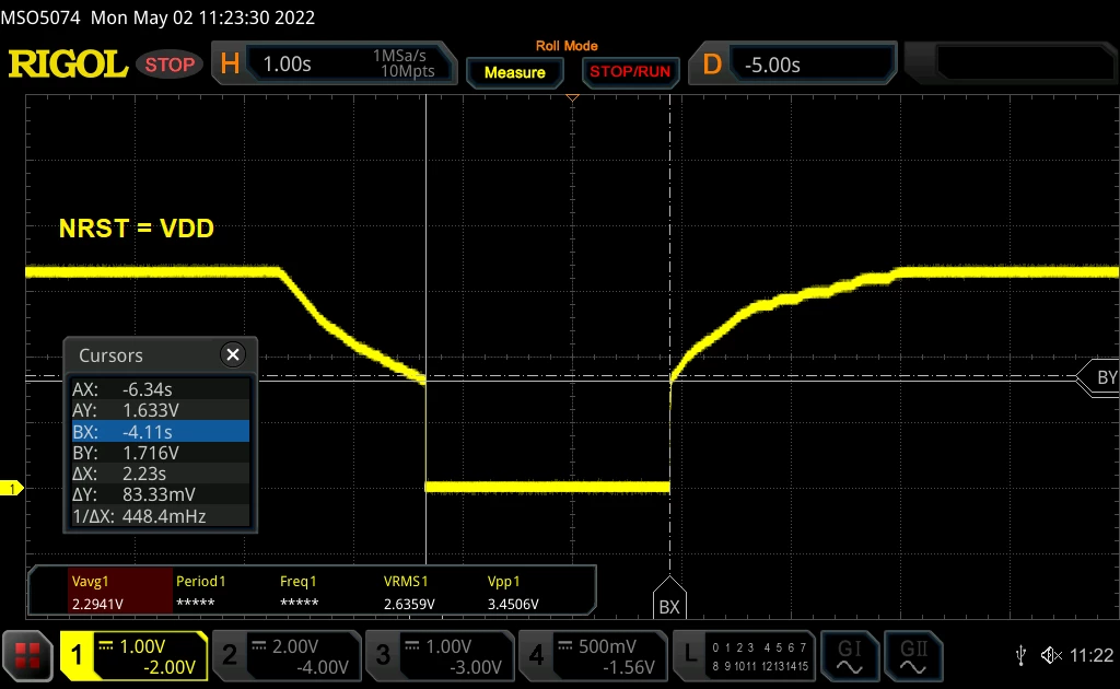

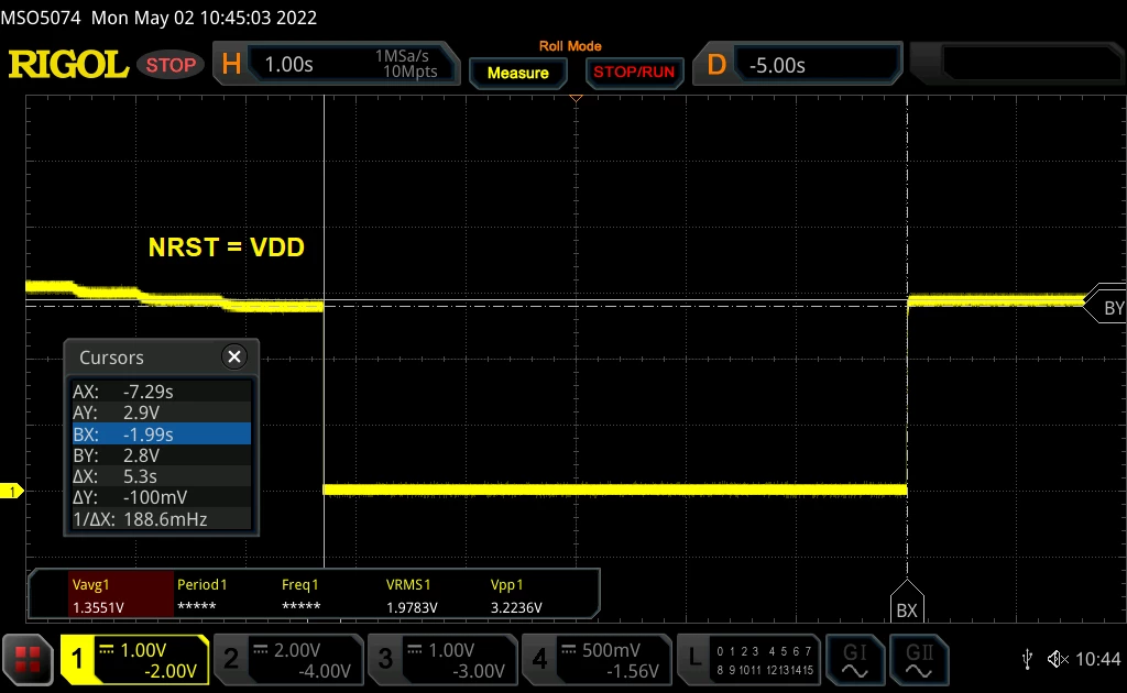

I have tested Power On Reset / Power Down Reset (POR/PDR) voltage threshold on two STM32G070RBT6 sourced by different suppliers. The threshold isn't matching the specified voltage 2.06<VPOR<2.14 and 1.96<VPDR<2.04 but it fits values stated in STM32G081 datasheet, 1.62<VPOR<1.70 and 1.60<VPDR<1.69. The brownout reset feature is functional on both STM32G070 and STM32G081 but it's not available on STM32G070 according to spec. I looks like STM32G070 uses the same silicon as STM32G081. Thus I'm concerning what to expect from different batches of STM32G070, can we relly on spec or rather consider STM32G070 to be equal with STM32G081.

LPiro.1
LPiro.1Author
May 3, 2022
thanks for confirmation, I was referring to real measurement done on G070 which violates POR/PDR specification as you can see attached.
  1. BOR disabled, POR/PDR active, thresholds out of spec
  2. BOR enabled, set to highest Level, thresholds within spec
