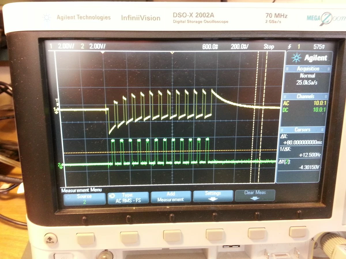

I am having trouble to get a couple of pins to toggle in PWM mode. It works, but there's a problem with the pin staying high. Here's what I am trying to do, it's quite simple, so I don't see why it is so much problem.
The timebase calculation is good, and I can generate frequencies +/- 100mHz. Note that both output pins *must* start at 0 (low), and return to 0 (low).
The 2 outputs must be PWM, call them Output1 and Output2. That wiould be Channel1 and Channel2. They will be exactly the same frequency, and exactly the same pulse width. The only difference is this: The start edge of Output 2 must be delayed from Output1 by an interval of timerPeriod / 2. Because of this, I understand that I cannot do this on the same timer
Here is basic code, 2 functions. The first one is the GPIO setup, the other is PWM configuration. The maximum frequency into the function is about 100Hz, the duty cycle is between 0.1 and 0.5.

See the attached image showing what the output looks like. The yellow trace is TIM3, the green is TIM4. Notice how TIM4 wants to stay high, this is exactly what must not occur.  Ideally the TIM3 should look just like TIM4, with a clean transition LOW to high at start and the same at the end. TIM4 is delayed by the correct amount, but the starting relationship isn't quite right, the trace looks goofy, and I'm not sure if it's because TIM3 starts at HIGH.

I have tried the above, forcing the pin low, configured as a pull-up, pull-down and pull to nothing. So what am I doing wrong? I've even tried every direct register setting instead of the TIM_Cmd function, made no difference.
Any help would be really appreciated. Really stuck here and I must get this working.

    Posted on January 31, 2015 at 21:13
    TIM3->CCR1=Period;

    Posted on February 01, 2015 at 14:19
    Mhmm... TIM4, green trace, shouldn't stay high? But green waveform looks okay for me. TIM3 or yellow trace behaves like you have connected the pin to a capacitor. You are aplying the same values to both of timers. So, I believe the bug isn't in the code. Maybe try to change the pin. I had a similar problem, the pin was high, but it should have been low, because on the discovery board was pull-up resistor.  Take a shot.
