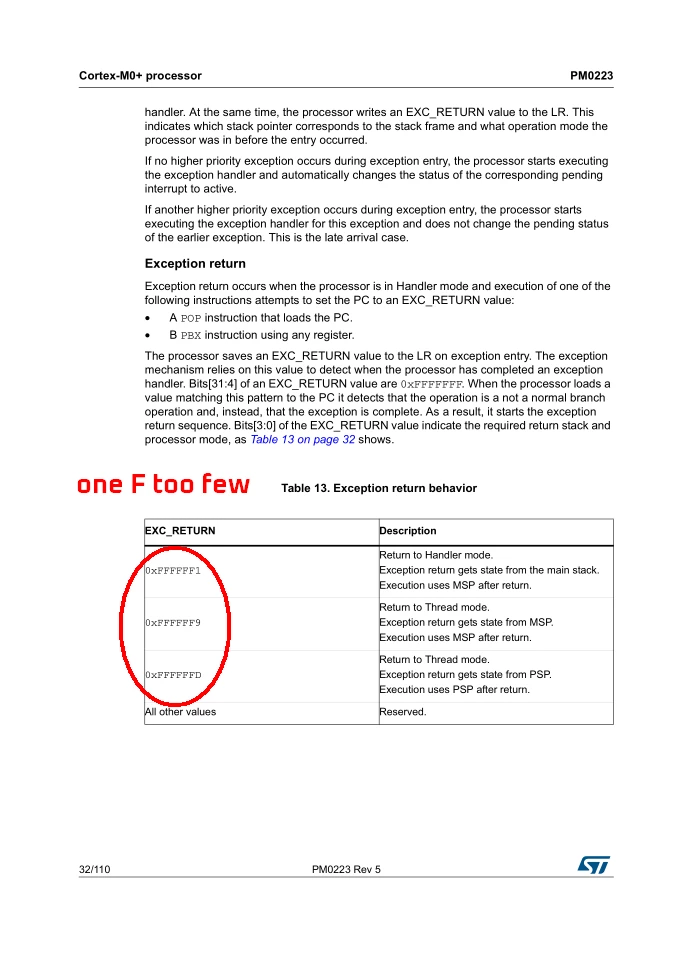

Hello @Community member​,
The issue has been solved in the rev6 of the PM0223.
Thank you for your contribution.

Well spotted, @Community member​, thank you. Obviously a typo while transferring it from the ARM documentation.
The issue has been internally reported. Thank you for your contribution.
Internal ticket number: 132054 (This is an internal tracking number and is not accessible or usable by customers).
