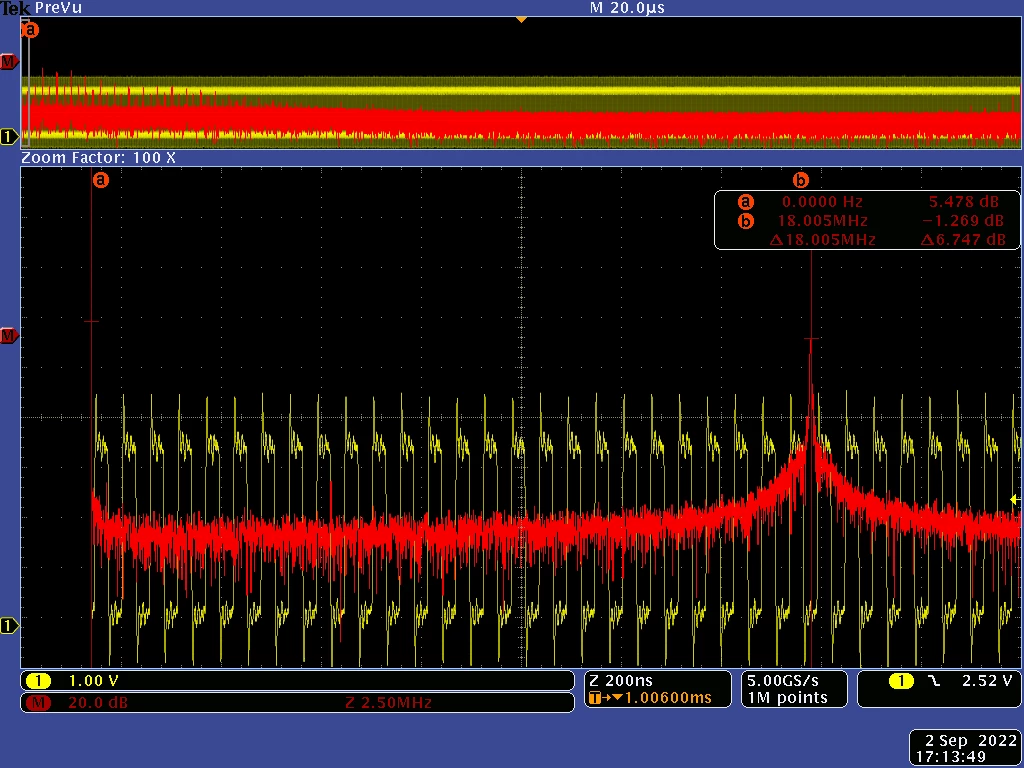

Then I configure the PLL like this:
 SET_BIT(RCC->AHB2ENR1, RCC_AHB2ENR1_GPIOAEN);
 SET_BIT(RCC->AHB3ENR, RCC_AHB3ENR_PWREN);
 /* make sure PLL1 is off */
 CLEAR_BIT(RCC->CR, RCC_CR_PLL1ON);
 MODIFY_REG(RCC->PLL1CFGR,
 RCC_PLL1CFGR_PLL1SRC | RCC_PLL1CFGR_PLL1RGE |
 RCC_PLL1CFGR_PLL1FRACEN | RCC_PLL1CFGR_PLL1M |
 RCC_PLL1CFGR_PLL1PEN | RCC_PLL1CFGR_PLL1QEN | RCC_PLL1CFGR_PLL1REN,
 RCC_PLL1CFGR_PLL1SRC_0 /* MSI PLL */ |
 RCC_PLL1CFGR_PLL1RGE /* MSI input range between 8 and 16 MHz */ |
 RCC_PLL1CFGR_PLL1M_0 /* divide 24 MHz by 2 (prescaler before VCO, M) */ |
 RCC_PLL1CFGR_PLL1REN /* enable output of PLL1R */
 CLEAR_REG(RCC->PLL1FRACR); /* ensure a defined (but as far unused) fractional divider */
 MODIFY_REG(RCC->PLL1DIVR,
 RCC_PLL1DIVR_PLL1N | RCC_PLL1DIVR_PLL1R, /* clear what we need */
 (11 << RCC_PLL1DIVR_PLL1N_Pos) /* VCO is this many times higher than its input frequency */ |
 (0 << RCC_PLL1DIVR_PLL1R_Pos) /* post divider: value + 1 (?) */

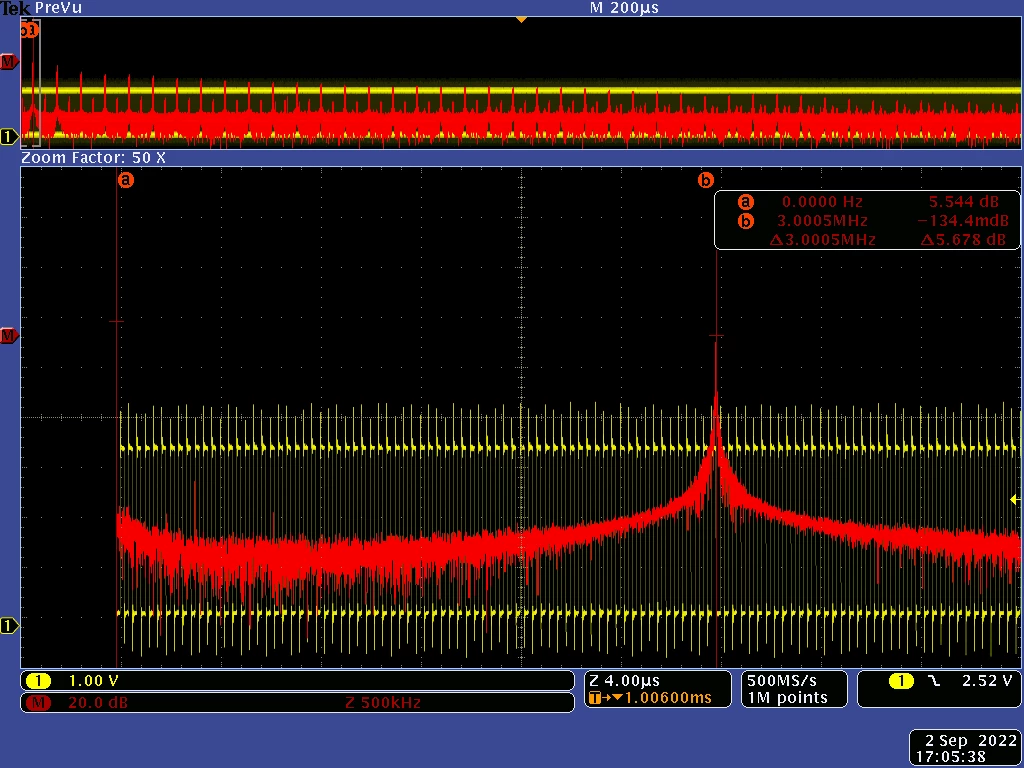

Then I setup the MCO like this:
 * MCO GPIO Configuration
 * CN13, Pin 2: PWM/D9
 * PA8 ------> MCO
 MODIFY_REG(GPIOA->MODER, GPIO_MODER_MODE8, (2 << GPIO_MODER_MODE8_Pos)); // set mode to alternate function
 CLEAR_BIT(GPIOA->OTYPER, GPIO_OTYPER_OT8); // set output type to push pull
 CLEAR_BIT(GPIOA->PUPDR, GPIO_PUPDR_PUPD8); // no pullup
 MODIFY_REG(GPIOA->OSPEEDR, GPIO_OSPEEDR_OSPEED8, (3 << GPIO_OSPEEDR_OSPEED8_Pos)); // set high speed for pins
 MODIFY_REG(GPIOA->AFR[1], GPIO_AFRH_AFSEL8, (0 << GPIO_AFRH_AFSEL8_Pos)); // select alternate function 0 (MCO) on pin
 * 0x00000000U MCO output disabled, no clock on MCO
 * RCC_CFGR1_MCOSEL_0 SYSCLK selection as MCO1 source
 * RCC_CFGR1_MCOSEL_1 MSIS selection as MCO1 source
 * (RCC_CFGR1_MCOSEL_0 | RCC_CFGR1_MCOSEL_1) HSI selection as MCO1 source
 * RCC_CFGR1_MCOSEL_2 HSE selection as MCO1 source
 * (RCC_CFGR1_MCOSEL_0 | RCC_CFGR1_MCOSEL_2) Main PLL selection as MCO1 source
 * (RCC_CFGR1_MCOSEL_1 | RCC_CFGR1_MCOSEL_2) LSI selection as MCO1 source
 * (RCC_CFGR1_MCOSEL_0 | RCC_CFGR1_MCOSEL_1| RCC_CFGR1_MCOSEL_2) LSE selection as MCO1 source
 * RCC_CFGR1_MCOSEL_3 HSI48 selection as MCO1 source
 * (RCC_CFGR1_MCOSEL_0 | RCC_CFGR1_MCOSEL_3) MSIK selection as MCO1 source
 MODIFY_REG(RCC->CFGR1, (RCC_CFGR1_MCOSEL | RCC_CFGR1_MCOPRE), (RCC_CFGR1_MCOSEL_0 | RCC_CFGR1_MCOSEL_2) | (3 << RCC_CFGR1_MCOPRE_Pos));
Just to check, this is what my scope gives me on MCO (PA/CN13-D9), when using SYSCLK on it. It gives nearly perfect 3MHz (24MHz/8). But the PLL1R is at 18 MHz, which means that the VCO has a frequency of 144 MHz, instead of the 132 MHz that I've configured (24MHz/2*11). What am I missing?0693W00000SuO9GQAV.png

Argh, found it N of 11 implies a divider of 12
 (11 << RCC_PLL1DIVR_PLL1N_Pos) /* VCO is this many times + 1 higher than its input frequency */ |
