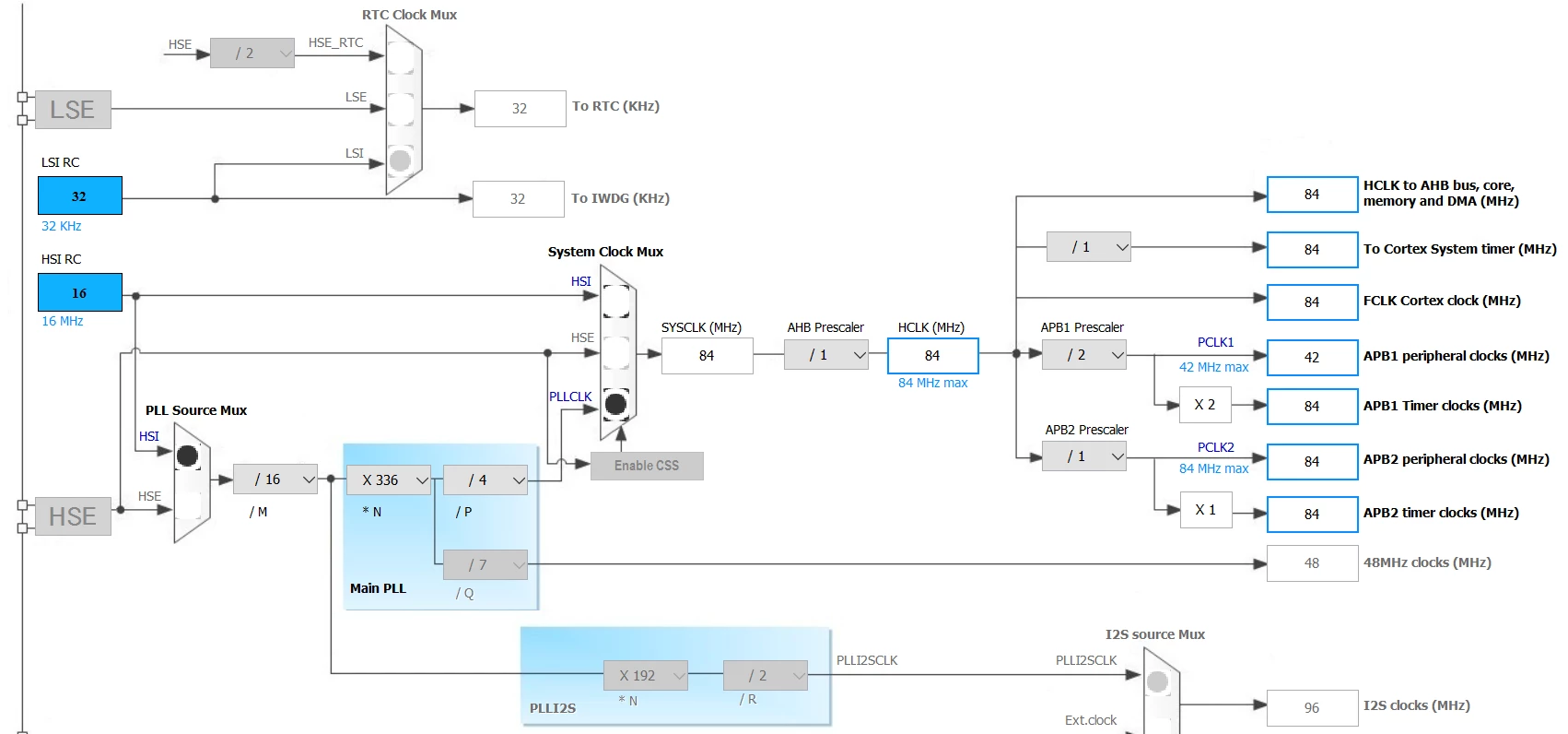

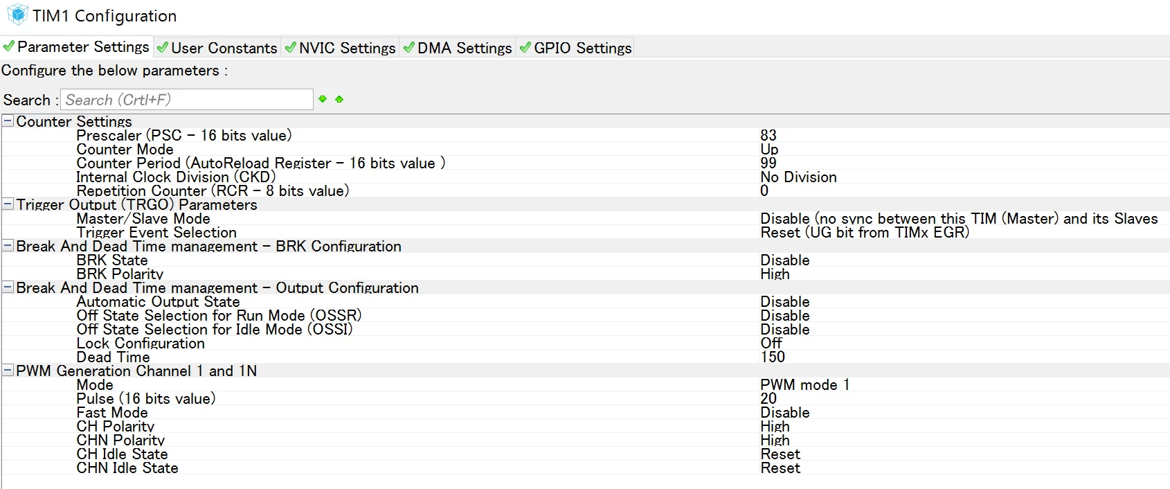

Please tell me how to calculate the dead time or determine dead time in this figure.
Posted on April 16, 2017 at 17:39
Thank you for your patronage.  Please tell me how to calculate the dead time or determine dead time in this figure.
I understand that
HCLK = 84MHz
Prescaler = 83
Counter Period = 99
Pulse = 20
Dead Time = 150
so frequency = 10kHz, Duty ratio = 20%.
But I can't understand dead time is 2?s.

    Basically it should be like 1/84000000 = 11.9ns. So you can have deadtime between 0 and 1511ns (11.9*127) with 11.9ns steps.
    So for 2us, deadtime value should be like 168.
    Thats what i think.

    No dead time is defined
    Ken Inoue
    Ken InoueAuthor
    Apr 17, 2017 10:58 AM UTC
    Posted on April 17, 2017 at 10:58
    I'm sorry. Dead time =150.
    Thats what i think.

    this assumes Tdts = internal clock..
