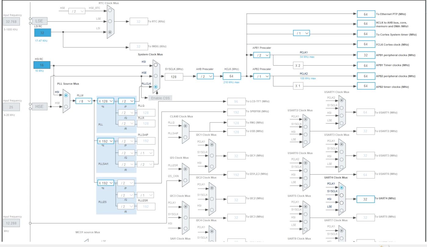

mravencaAuthor
Mar 18, 2024 11:38 AM UTC
Can you please check my clock setup and tell me the ADC Sampling Frequency?
Here is the clock setup:
As I wrote before, I am setting sConfig.SamplingTime = ADC_SAMPLETIME_112CYCLES.
Thank you very much!
Vaclav
AScha.3
AScha.3Best answer
Mar 18, 2024 12:16 PM UTC
So AHB is at 64M now; divider 4 -> 16M ; = 62,5ns
adc sampl. 112 + 12 (12 bit resolution) -> 124 cyc.
16M / 124 = 129 kHz , sampling.
