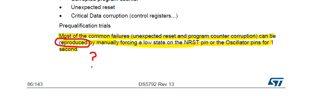

I think the word "reproduced" should not be used in this yellow marked sentence,and the word "resolved" should replace the word "reproduced",due to the purpose of NRST pin is to solve the most of common failures,not to reproduce them。 Am I right?

This world should be true since the failures caused by EMC interference usually result in PC lost, system clock drop or device reset and the design of the HW+SW have to be hardened in the way to deal with these interferences and to allow system self-recovery if such failures occur.
These events can be eventually "emulated" by stopping oscillation of external Xtal (if such is used as a source for system clock) or triggering reset by low level on NRST pin.

Yes, after reading your reply,I understand the meaning of this paragraph.thank you.
Besides, is the NRST pin a active-LOW reset pin?if it is,then,what does it reset?clear all(data in mcu,count in progress,clock signnal...)?
