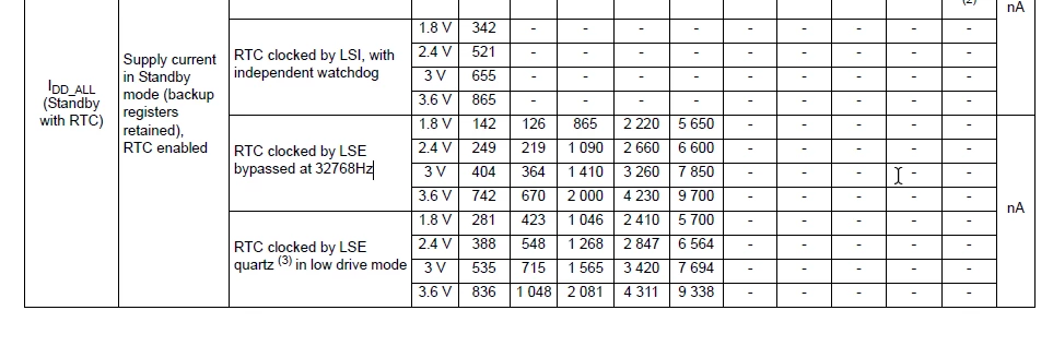

When it went into standby mode , the whole board was consuming 146uA. So the processor was consuming 146 -53uA (before the processor was added), a 96uA. Looking at the below table (I am using LSE and have a 32768KHz crystal attached) The power is close to 600nA ,

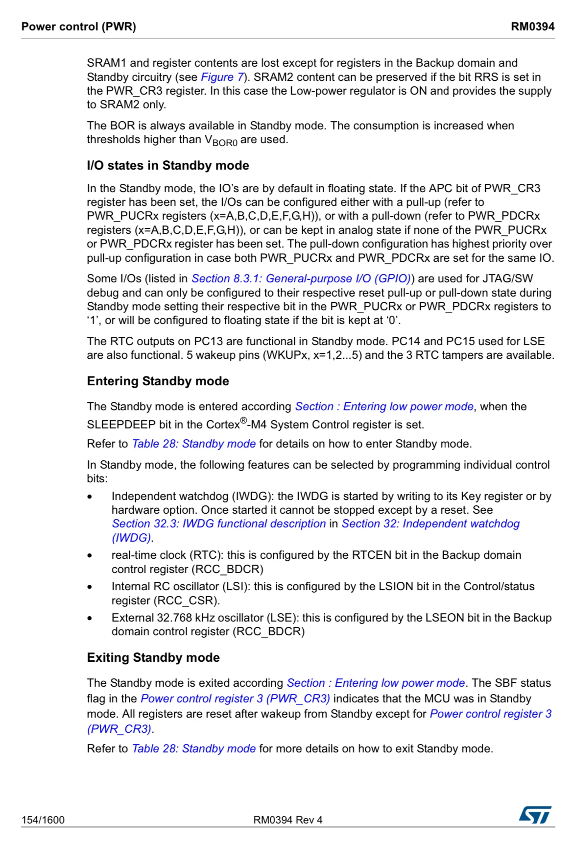

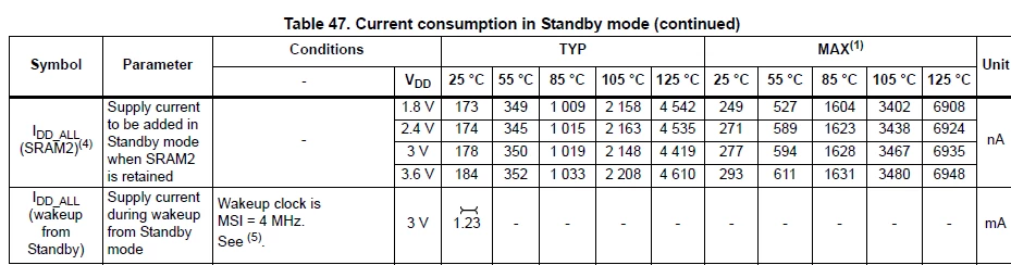

And with the above bottom table I have to add approx 180na for the ram. So in total the power should approx be 780na . Which is nothing like the 96ua which its drawing. To place into standby mode I am doing the following:
Switching off USB (not sure if needed)
RCC->APB1RSTR1 |= RCC_APB1RSTR1_USBFSRST;
RCC->APB1RSTR1 &= ~RCC_APB1RSTR1_USBFSRST;
RCC->APB1ENR1 &= ~RCC_APB1ENR1_USBFSEN;
Disable clocks
__HAL_RCC_GPIOA_CLK_DISABLE();
__HAL_RCC_GPIOB_CLK_DISABLE();
__HAL_RCC_GPIOC_CLK_DISABLE();
__HAL_RCC_GPIOD_CLK_DISABLE();
HAL_PWREx_EnableSRAM2ContentRetention();
HAL_PWR_EnterSTANDBYMode();
I dont know if I am missing anything else to get this near to the 780na I think I should get.

One hypothesis to this extra consumption would be the I/O states at board level before and during standby mode . can You please check and let us know if the observed behavior is fixed ?
