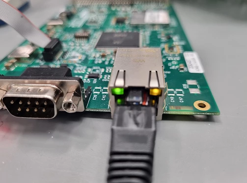

Hi, I'm trying to get the ethernet interface to work on an STM32H745. After fixing various hardware problems, now I don't just have software problems.
I created a simple project with CubeMX, basically I did these things:
- Enabled ethrmnet interfaces
- Set all pins related to "very high speed"
- Enabled LWIP with static IP set to 10.0.1.100/24
- Increased Heap Memory size to 10k
- Configured the MPU as in the attached document
- In the flash.ld file I added this piece:
.lwip_sec (NOLOAD) :
. = ABSOLUTE(0x30000000);
*(.RxDecripSection)
. = ABSOLUTE(0x30000200);
*(.TxDecripSection)
} >RAM_D2
Then in the mail loop I just put this function: MX_LWIP_Process();
I connected an ethernet cable to the board, the link status LEDs light up well, but I can't ping the board's IP.
I think I've done a really basic setup, where could I have gone wrong?
The only doubts I have are about memory:
- have I configured the MPU correctly?
- did I modify the FLASH.ld file correctly?
- Should I somehow configure the address of the LWIP_RAM_HEAP_POINTER (RAM Heap Pointer) in the MPU or in the FLASH.ld file, if so, how?
- Am I missing any other steps to do? Something to change in my confgiration?
I saw that there are many many posts on this topic, I have read many but I haven't been able to solve the problem yet.
Can you help me?
