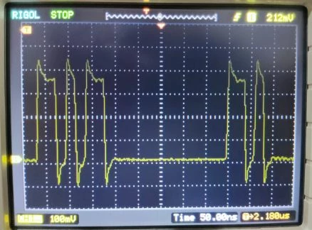

The maximum software pin toggling speed I am able to achieve is about 0.7 us.
It looks a bit slow for a M0+ running at 48 mhz.

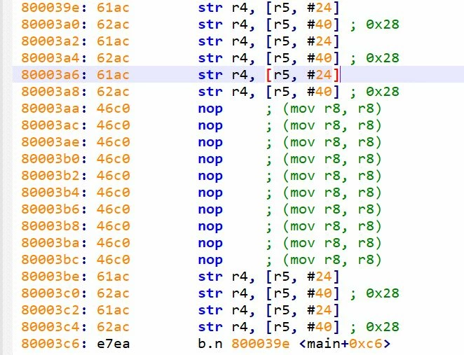

Looking at listing file, there is no library overhead (I am using LL).
Can someone shed some light on this?

Solved, thank you all.
My bad. Inexperienced with Stm32Cube, I was always flashing the MCU with the Debug build.
Attached there are the listing of the main loop and the output.
Show.

Yes, it does indeed run at 48 mhz, I checked it with a scope on pin 5, configured as MCO.
I have not the listing at hand, I'll post it as soon as I can.
