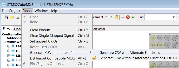

We are planning to use STM32H753xI in our design. We should prepare Architectural Block diagram of the Board. To do that we need to know the Pin multiplexing details of the device and accordingly plan the Interfaces in the architecture. Can you please provide the Pin multiplexing details in the form of Excel sheet or any software through which we can easily select one of  the Options out of the available Multiplexing.

    Hi
    hn.vijetha
    Pins multiplexing is available in the datasheet of the product you selected,
    http://www.st.com/resource/en/datasheet/stm32h753xi.pdf
    related one in your case.
    Otherwise, you should be able to have this multiplexing in a .csv file that you get using STM32CubeMX:
    1. Open a new project to use STM32H753XI device you select from the STM32CubeMX interface
    2. Go to ''Pinout'' tab, and then select ''Generate CSV pinout text file'' as following:
    -Amel

    Vijetha hn
    Feb 14, 2018 1:06 PM UTC
    Posted on February 14, 2018 at 13:06
    Is this STM32CubeMX software available as Evaluation version or we need to buy license? I want it just to check Pin Multiplexing and select the interfaces accordingly.
