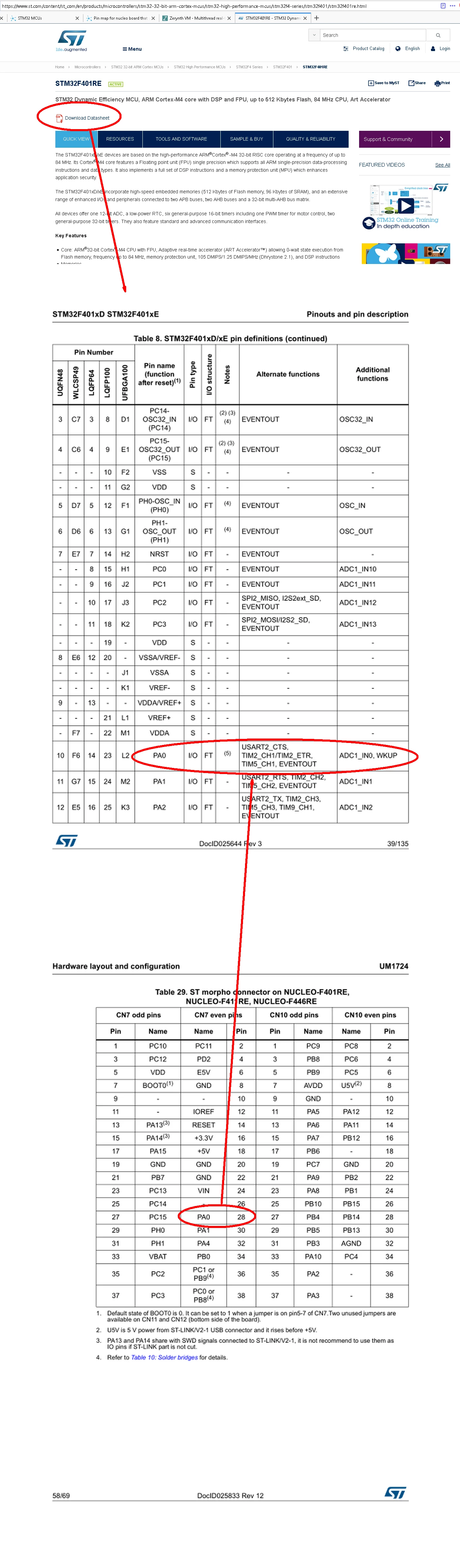

Pin map for nucleo board that shows all pins, not just Uno / Morpho pins.
I am interested in using one of the Nucleo boards, either F401RE or F429ZI (these two are both supported by Zerynth ide) but I need 15 adc channels. The 401 has 1 adc with 16 channels, the 429 had 3 adcs and 24 channels. But in all the documentation it appears that not all the adcs are available. On both boards they seem to stop at 6, which is what the Arduino Uno offers. Both boards have a lot of other (non Uno) pins available but I have not been able to find in any of the documentation what the pins are for. I wold hope that 10 of them (on the 401) would be the other 10 adcs. Can anyone please point me in the direction of some documentation that shows the whole pin map for these boards?
Thanks,
Ian

    Thank you very much, I would never have found this information without help!
    ;) Ian
